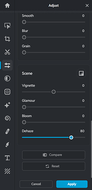

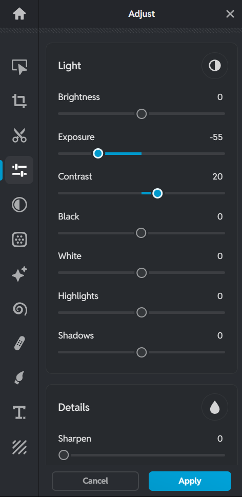

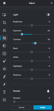

(the following is optional but will make the Sketch Look nicer)
  1. Navigate to this Website (this is an Online Photo Editor)
  2. Upload your images one at a time and use these settings for each:
  3. Select Apply and Export each of your images as a JPEG.

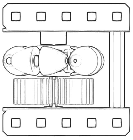

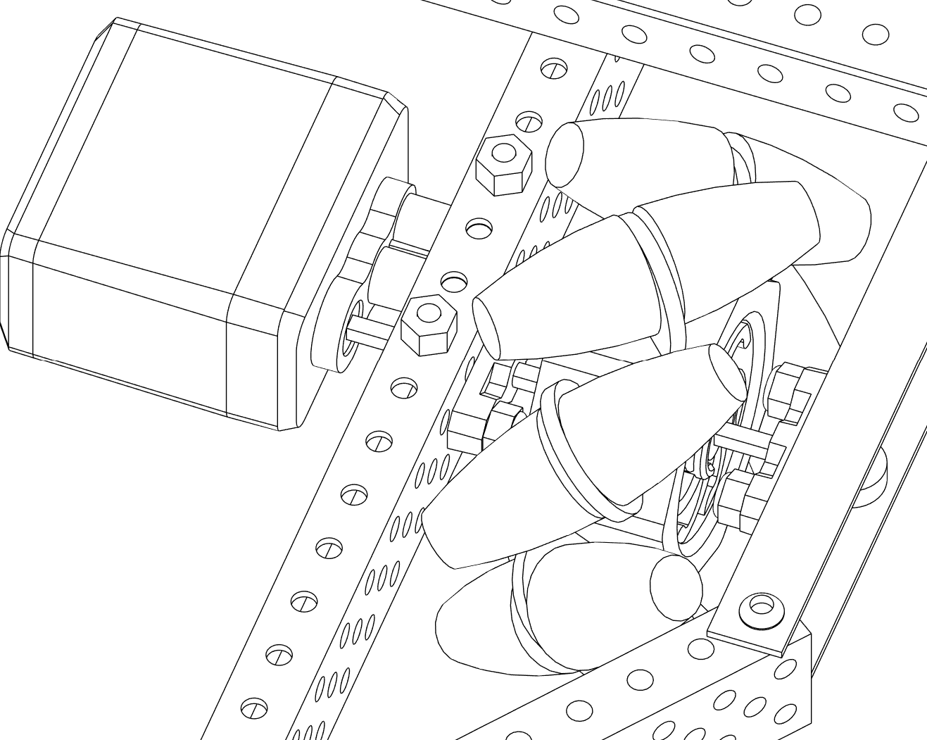

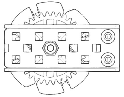

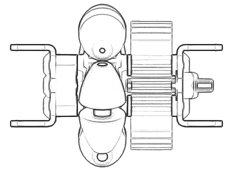

Here is the final product:
(note: this was done a very simple CAD, but I have tested with more Advanced Models)

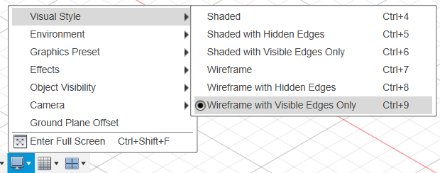

Or you can just select the wireframe rendering style
And maybe disable the layout grid.
@u89djt how do you activate the wireframe setting?
That’s the wireframe rendering style in Fusion 360 - you can see the menu sequence in my first image.
