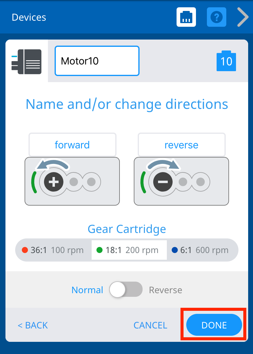

When you open the code, and it has you set the motors to the ports
Make sure the arrows are facing the same way as the motors on the bot. This can be changed by the toggle at the bottom.

If you are using the build in program called drive, there should be an option on the brain to reverse steering. If that doesn’t work, try swapping the motor ports. Hope this helps :))
