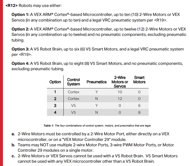

Also it depends on motor allocation and how many v5 you are allowed vs how many 393 and how many motor functions you need … here goes nothing
You are allowed 8 v5 motors with no pneumatics it 6 with pneumatics.
Take a look at this chart from the game manual
