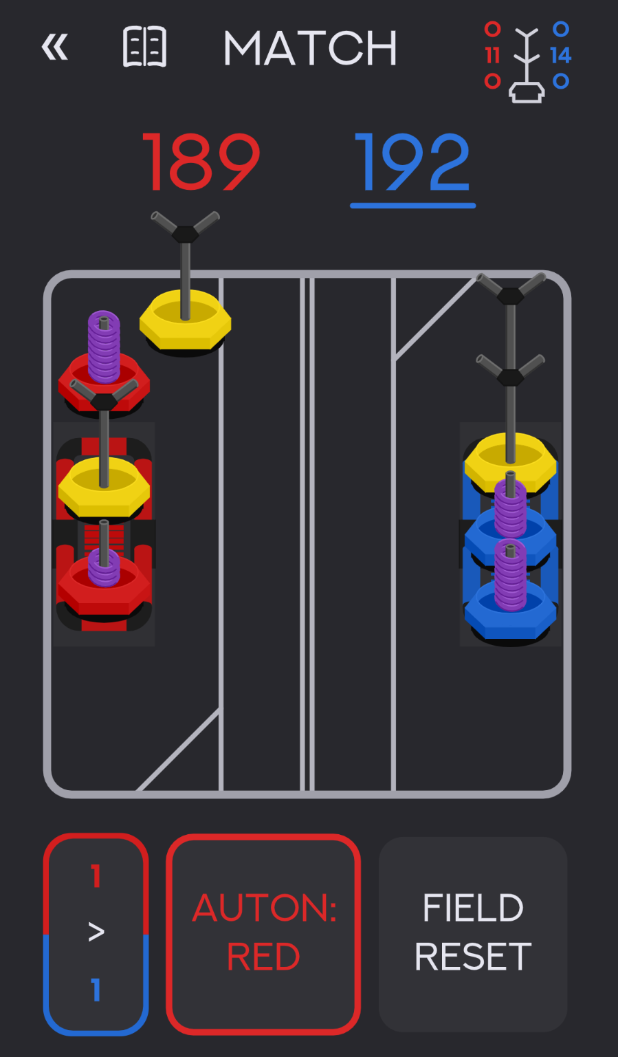

Here’s what I got on a scoring app :
There are 8 rings on one red alliance mobile goal and 3 on the other. The blue mobile goals have 8 rings on one and 6 on the other. Correct my ring count on the red mobile goals if I’m wrong, but blue could have actually easily won if they took the time to score rings while red was turtling and parked in the last 30 seconds. Furthermore, red alliance couldn’t even defend against blue scoring rings without un-turtling. Given all of this, the strategy is intimidating at first, but easily defeated if you play it right.

@ezl has done up the points to show that blue still stand a chance to win, even with red scoring rings.
My mentioned scenario was based on what happened in the video - and it is a fact that the red alliance left the tall goal for the blue. Just that the blue didn’t make use of it.
