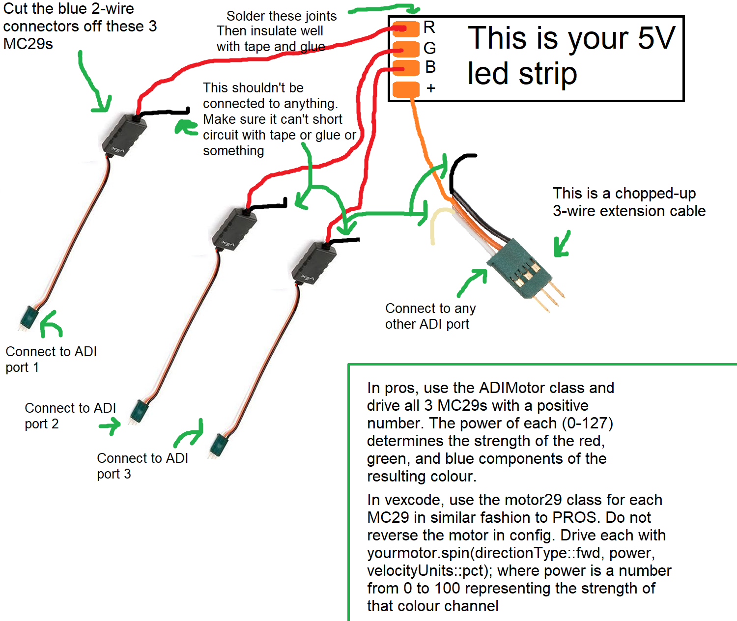

This is a tutorial on how you can make custom RGB lights that can be controlled with a V5 Brain.
This is the code used in the video.
Feel free to ask any questions you might have.

Taran, there are multiple safety issues with the way you do this project!
!!! DANGER - DO NOT DO IT THIS WAY !!!
If you don’t program it correctly - the consequences could range from smoking MC29 controllers to frying ADI ports power rail, all the way to permanently damaging V5 brain or even setting the battery on fire!
I will leave it up to you all as an exercise (for now) to figure out why it is the case before giving my explanations later in this topic.
@DRow or @jpearman could you, please, edit the OP to put “DANGER - DO NOT DO IT THIS WAY” in the title and a warning that RGB lighting should never be implemented this way and the reasons why will be discussed later in the topic.
Also, Taran, you will need to edit your video with proper warnings before anyone followed your tutorial.

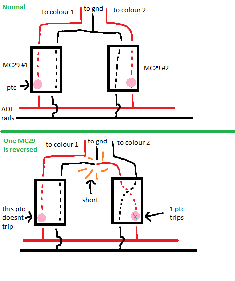

Please elaborate on this. The only risk I can think of is shorting the mc29 outputs together.
This happened fairly frequently in cortex days including in my own club, and, on cortex at least, it appears to rarely (if ever) kill the cortex port - it just kills the mc29. The is because the mc29 has a PTC which prevents it from drawing too much current from the ADI/3wire ports.
In addition to this, this page specifies a maximum current of 2A, which makes me think that there probably is an internal PTC (i.e. in the brain). This should prevent an overcurrent/short from killing the ADI power rail as you suggest may be a possible consequence.
I highly doubt a short/overcurrent even on a (hypothetically) unprotected ADI power rail would cause the battery to catch fire. This page specifies a maximum battery current of 20A, again implying a fuse. Also, not having a current limiter on a lithium battery is just plain stupid, and while the V5 system has some issues I seriously doubt the designers forgot about basic battery safety.
While soldering anything always carries a risk of shorting something, it is certainly possible to do it right and mitigate risk. It is good practice to cut the stripped (copper exposed) lengths of wires as short as possible to reduce the chance of them touching. In Taran’s video he makes them very long which isn’t ideal (see 6:00 mins).
It’s also a good idea to make sure that each wire is secured to the LED strip’s copper pad by giving it a tug after soldering.
Encasing the whole thing in hot glue and tape and mounting it securely to prevent excess force on the soldered joints should mitigate most of the risk.
Therefore, I think the only likely consequence of doing it wrong and shorting the mc29 outputs together would be a melted mc29. I think the mc29’s and internal ADI power rail’s PTCs would prevent the ADI power rail from being damaged. I highly doubt that any short circuit on any power rail would cause a battery fire, just because it is such an obvious risk with easy mitigations that will be in place.

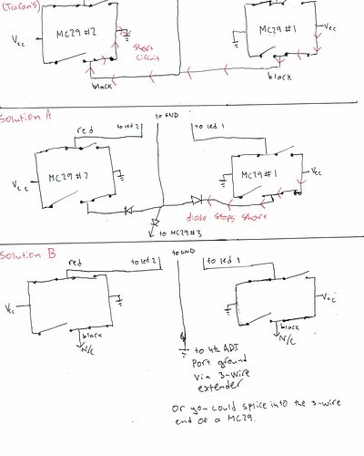

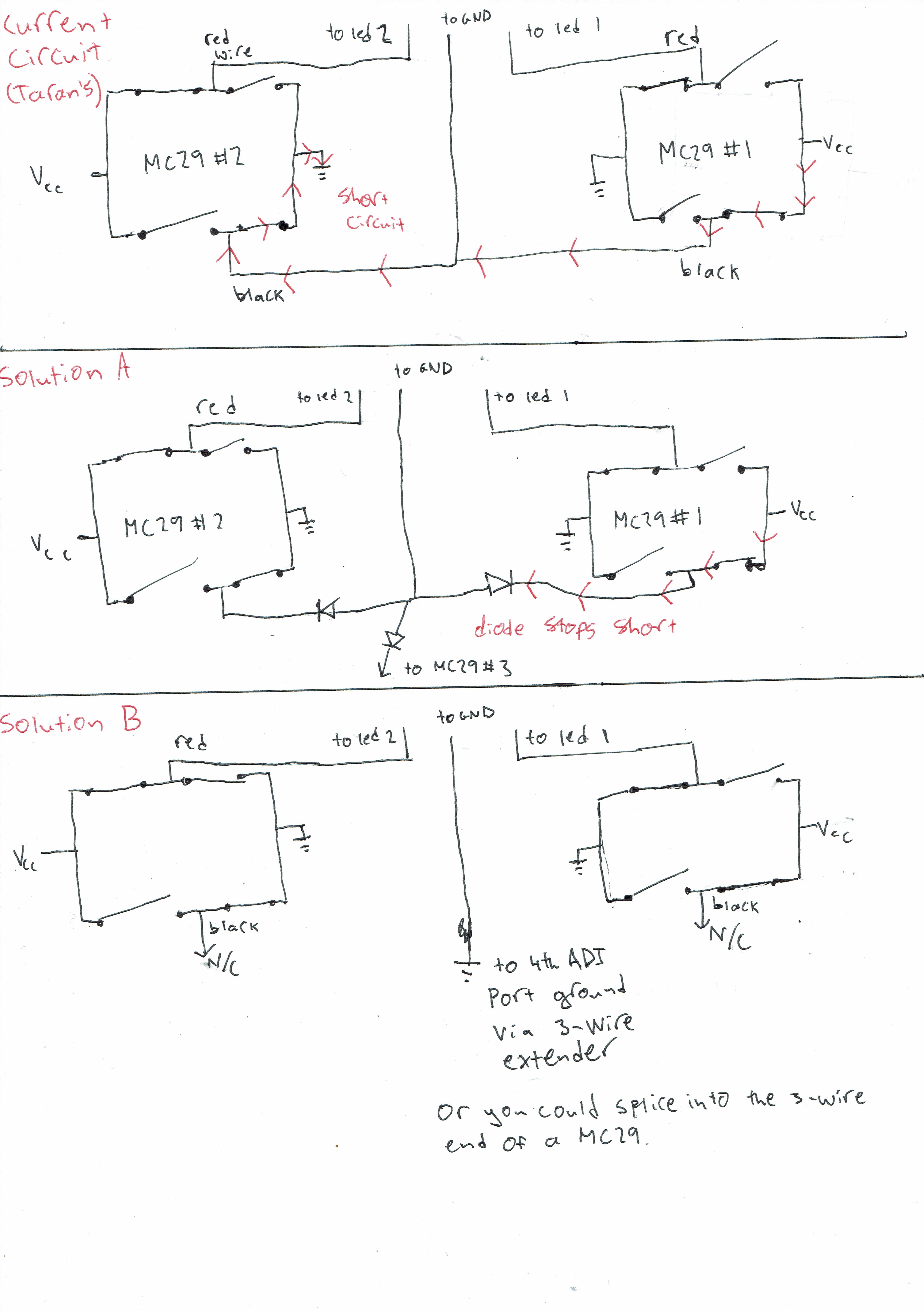

There are a couple of promising solutions to prevent a short being possible in hardware.
One (solution A in below picture) would be to put a diode in series with the black wire output of each MC29. This would prevent current flowing forward through the black wire, so no short could happen if you accidentally reversed the polarity. The disadvantage with this is that the diode will drop about 0.6V, so the LEDs might be ever so slightly dimmer.
Solution B is to disconnect the black wire from each MC29 completely and run a 3-wire extension from another (4th) ADI port. Snip the female end and connect only the ground (black, probably) wire to the LED strip’s ground. Since the ground now runs directly to the ADI ground rail, it won’t short out regardless of how badly you screw up your programming. The disadvantage of this is that it uses up another ADI port. Instead of getting a ground from a new ADI port you could also just splice it into the ground wire on the 3-wire end of one of the MC29s, saving a port. That might be even less legal than the rest of this idea.
Simplified diagram of H-bridges with Taran’s initial circuit and solutions A and B:
(Note MC29#1 on the right is reversed like it would be if it was given a negative power, which would, in the first diagram, cause a short)
vex hbridge elds
I think the easiest solution would just be to change the function lights() to this to ensure you can’t mess it up and not bother with the extra hardware.
void lights(int _red, int _green, int _blue) {
    red.set_value(abs(_red / 2));
    green.set_value(abs(_green / 2));
    blue.set_value(abs(_blue / 2));
@Sylvie, you said this was legal. However, wouldn’t this violate R13.D? “VEX electronics may not be used as non-functional decorations”. Might be worth a QnA perhaps.
Also, I’m not sure about the legality of diodes since the vex people always seem to be a bit frightened by electronics but I suppose they’re part of the decoration.
Let me know what you all think about my solutions.

Thanks @technik3k. Jpearman did say “there is current limiting on the 5V output” (of the brain), so I think the hardware would forgive a non-prolonged short while testing. I totally agree, however, that shorting should be avoided by using a circuit where software cannot cause one especially since this tutorial is aimed towards the wider vex student group who are probably less careful and knowledgeable about the risks.
My previous comments had a few errors. One of those is my assumption that the MC29s have PTCs, which, as jpearman said, is not the case. This makes a lot of sense given how often they melt from shorts. Therefore, to anyone reading this thread in the future, please ignore what I said above about PTCs in the mc29s. The actual mechanism of how the short comes about is (I think) still correct.

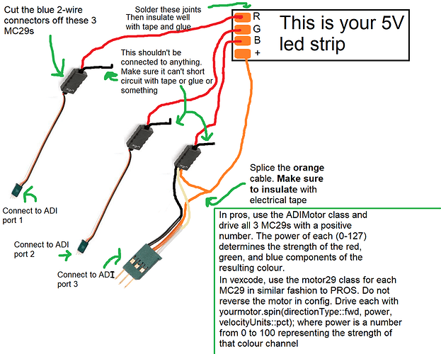

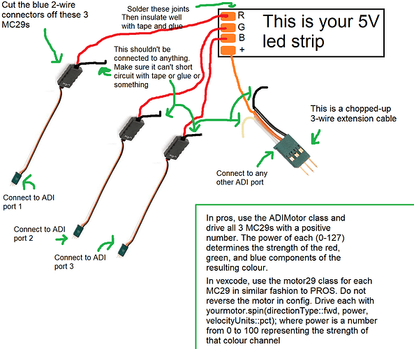

Another thing that nobody seems to have talked about is the connections on almost all RGB led strips (including Taran’s). These strips have a common positive and switch the negative of each colour channel, rather than the common ground and switched positive that we generally expect. You can read more about why this is here.
The (seemingly) strange thing is that Taran connected the black wire from the MC29 to the common positive of the LED strip. It turns out that a positive number/forward input in both pros’s ADIMotor and VexCode’s motor29 classes make the MC29’s black wire positive and red wire negative. This is not what I (and I presume others) would expect but it explains why Taran’s circuit works. This means that the R, G, and B pins on the LED strip are the switched negatives (connected to the red wires from each MC29) and the + pin on the strip is the common positive (black wires).
I’m not too sure why positive number resulting in black being positive would be the case, I guess to make anticlockwise (looking into the shaft) positive as is convention in maths.
The upshot of all this is that instead of running a common ground via a 3-wire extension or splicing into the 3-wire in the MC29, we need to get a common +5v. This is easy enough to do in the same way by using the orange wire instead of black.
I have drawn upon the full extent of my artistic ability to produce diagrams on how to wire up your own LED strip which are attached to this post. The first option uses 4 ADI ports but requires a bit less soldering, while the second option uses 3 and requires a bit more soldering. I’m no expert on the legality of any of this but I’d guess that the first option is less illegal.

Method 1, using 4 ADI pins.
vex led strip option 1
Method 2, using 3 ADI pins.
vex led strip option 2
