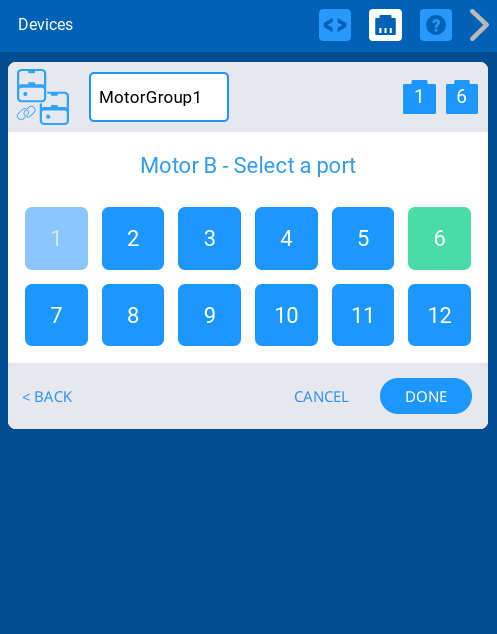

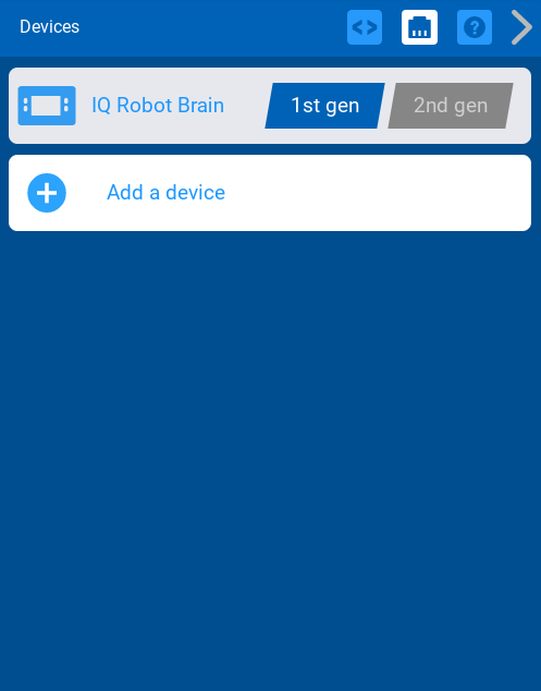

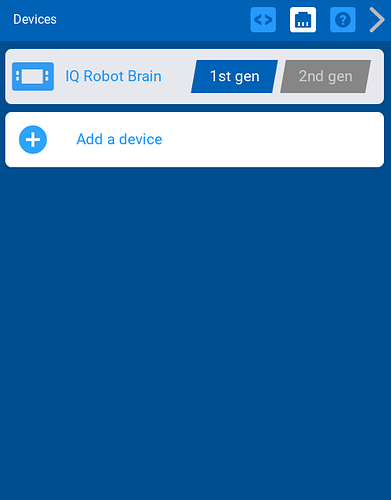

I assume you can configure motors the same way in VRC as in IQ, but I don’t do VRC. This is how you would configure a motor group with one motor reversed:

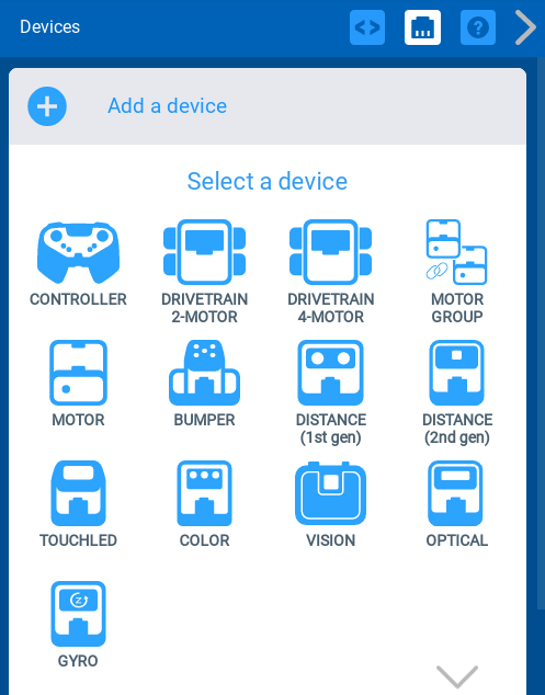

Click “Add a device”
Click “Motor Group”
Click whichever port one motor is in
And then whichever port the other one is in

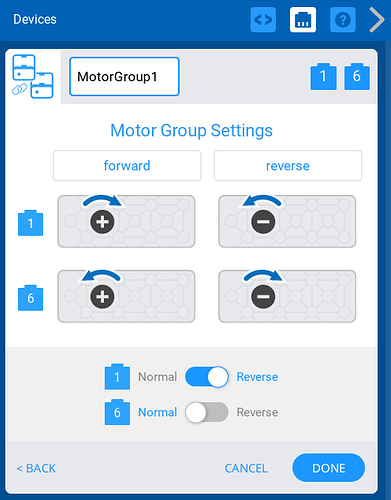

And then click the forward-reverse toggle to reverse whichever one(s) you want. In IQ, you can even name the directions something other than “forward” and “reverse”.
You can reverse it in pro v5. It’s a little switch when you go into the motor. That way, any instance of that motor in the code you don’t have to worry about keeping track of forward and reverse.
