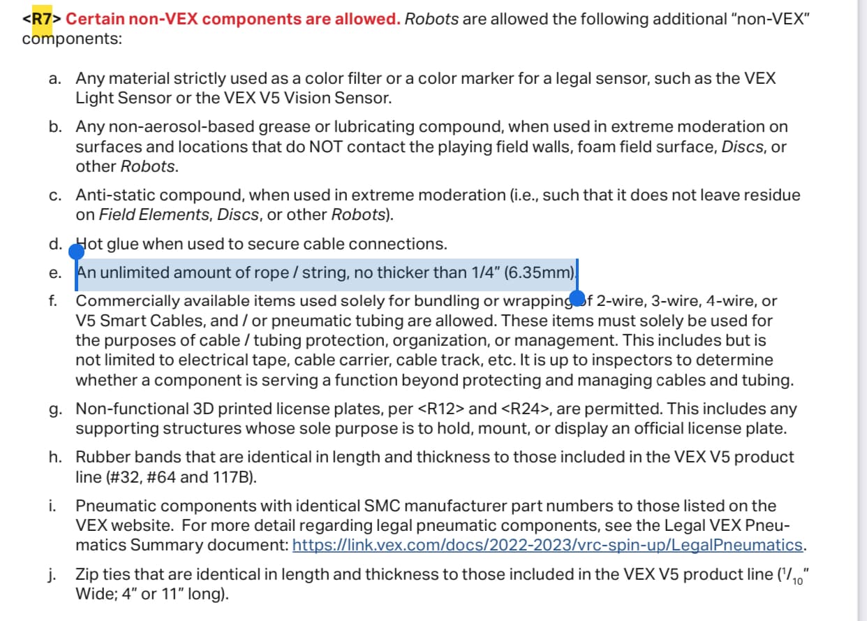

I have a question. Can we use any type of long string or rope in Vex v5 in competitions?

This question is best answered by rule R7 in the game manual, which you can find at this link:

Thanks, I look into odometry. But with the rope question is there any rope or string that is legal in competitions for vex v5?
so we cannot use any rope alright. Thanks tho :slight_smile:
Uhh… check in the manual again.
Read the rule: R7 e —> Page 42
Unlimited amount of rope/string (with a limit on size)
Did you read R7?

<R7>:
e. An unlimited amount of rope / string, no thicker than 1/4".
What are you talking about? R7 legalizes any rope no thicker than 1/4"! Where did this come from?
