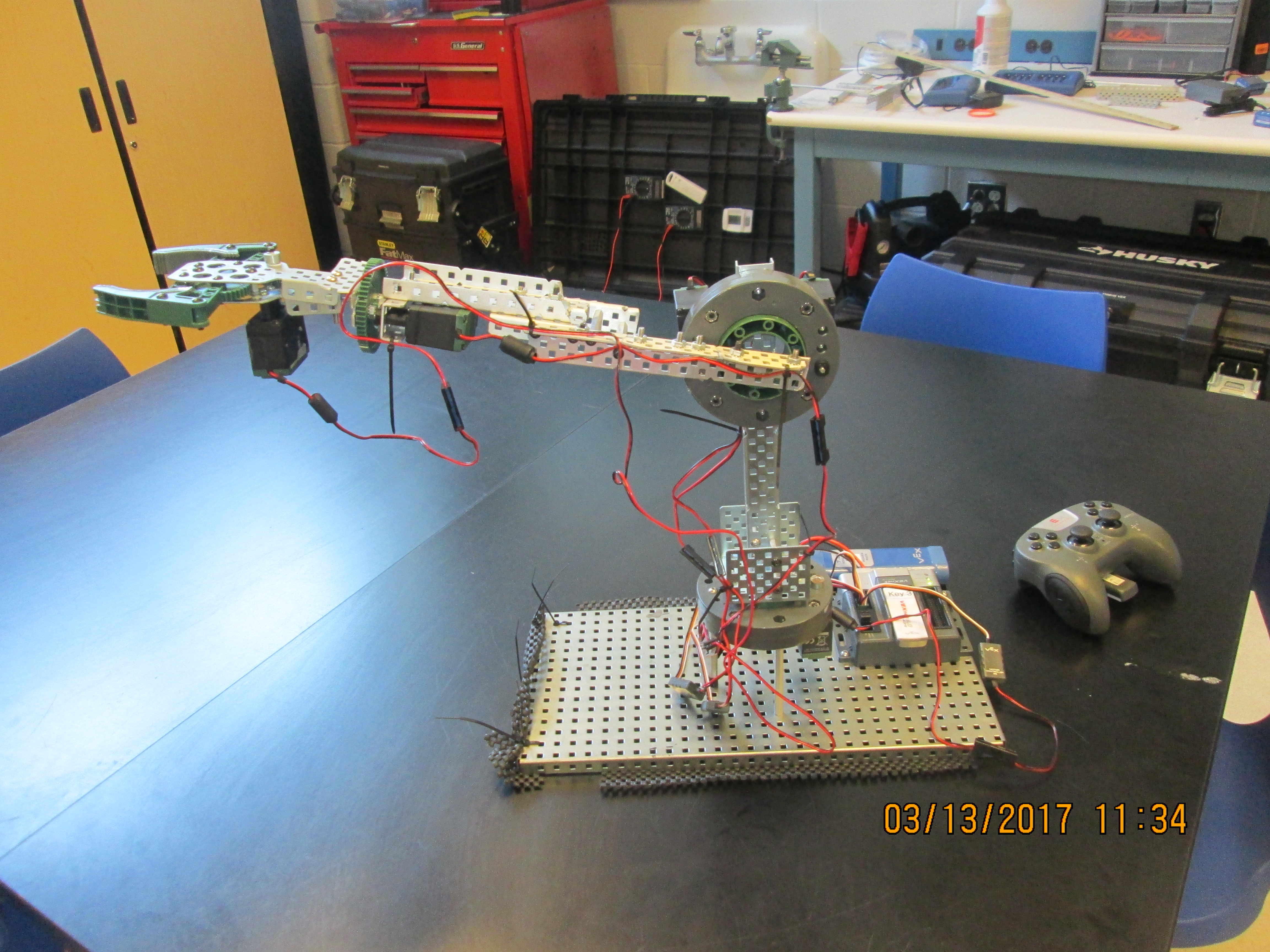

Actually this won’t be a typical driving robot. I’m using these sensors to control a robotics arm that I built for a senior project. I’ve attached a picture of the arm in this post for reference. As of right now I have two sensors. One for left / right, the other for up/down. However, I’m having problems with it detecting my hand and not the other sensor. Is there a way to have two dead-zones for the sensors? (one for outside and one for the center)

after testing it, here are the results:
  • before starting, make sure your “hand” is in the dead zone (its a 8x7 rectangle).
  • for some reason, the sensors have trouble detecting my hand so I used a pole instead.
  • when stopping, make sure your “hand” is in the dead zone otherwise it won’t stop.
So does anyone have any ideas of how to improve it?
