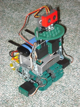

Here is the robot that the code is being used with.
I love that robot, it’s so small…
Thanks, I designed it to be really really really small. There are only 2 metal parts used in the robot, not including the bars, gussets and the beams. I wanted to make something that was small and efficient.
