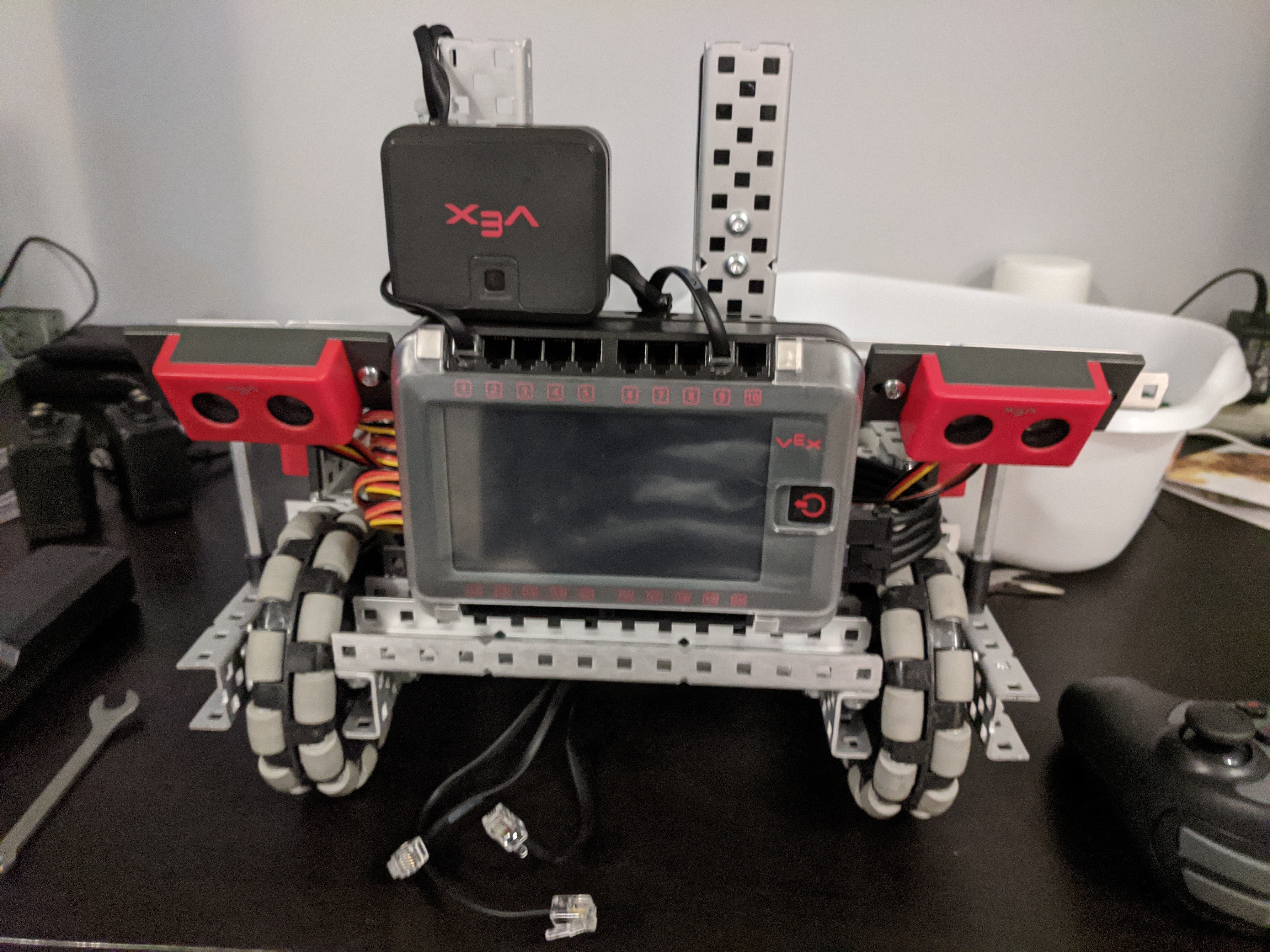

I have a robot that is required to drive autonomously. To achieve that I’m using 4 ultrasonic sensors. Two of them are in the front at an angle so that they can see in front of the robot and down a bit. While running my program the sensors will occasionally report a -1 instead of a real value. It’s every couple of seconds and when it starts it doesn’t seem to stop without moving the robot of putting something in front of the sensor. I provided my code but I’m sure that it isn’t it but threw it in anyway. IMG_20200730_143536

-1 simply means the sonar doesn’t have a valid reading, just ignore it.
Note, if you are averaging values, remember not to include the - 1.
@jpearman @tabor473 Thanks for the confirmation that it was an error state. After a lot of testing I found that it had to do with the sensors being angled.
I guess I’ll mention to myself.
Averaging can have a bunch of problems and often a median filter is better. It also has the fortunate biproduct of naturally not being effected by the - 1. (assuming small amount of - 1s)
