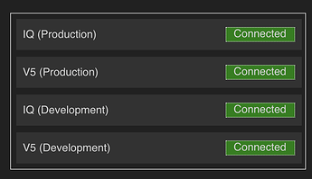

Servers are currently up and running…
27%20PM
