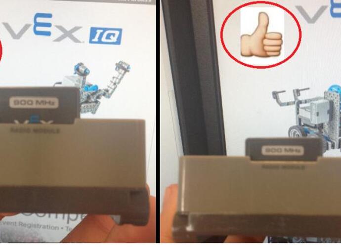

Let’s start with some basic troubleshooting, please make sure the radios are inserted all the way down (picture attached). No blue logo should be showing, it helps if you push the red button on the brain while inserting, while on the Controller it helps if you remove the battery. If his fails, you can also swap the radio from the controller into the brain and the one from the brain into the controller.

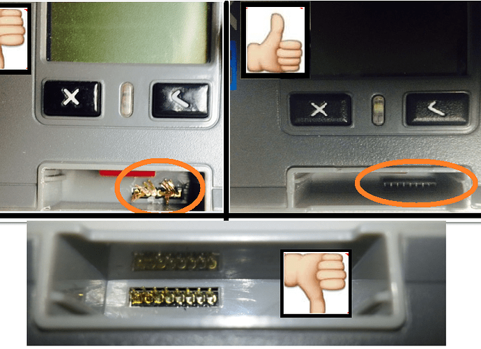

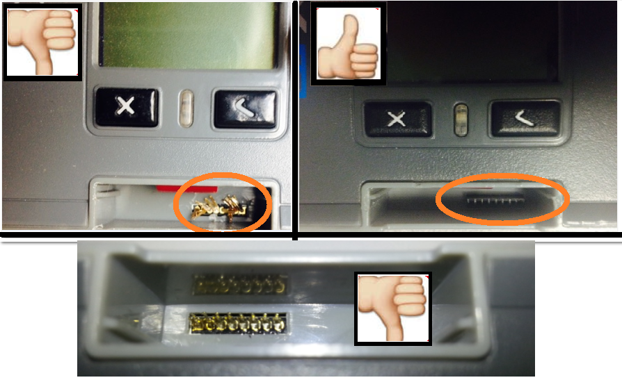

If all this fails, please remove your radios and inspect the radio slot on the Controller & Brain. Make sure there are no exposed or smashed pins (picture attached).
The radios are usually a tight fit, so don’t be afraid to pull-out hard when trying to remove them. Make sure that you are pressing and holding the red button on the brain, on the controller make sure to remove the battery door.
