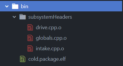

is this what you’re talking about?
these pop up when i build my project.
The .cpp.o files should be there, but the output you posted above implies there is a template.cpp inside bin… Not really sure what to make of that.

Not sure how you got the error you posted at the start of this, but the relevant one is here:
bin/subsystemHeaders/globals.cpp.o:(.bss.inertial+0x0): multiple definition of `inertial’
bin/subsystemHeaders/drive.cpp.o:(.bss.inertial+0x0): first defined here
You probably want to delete the inerti in drive.cpp,as it’s declared in a header and defined in globals.cpp
Well, turns out, it actually worked. (I still honestly have no idea why I got my original error…)
