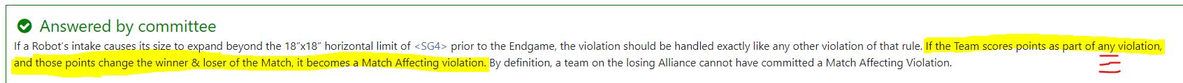

Cherry picking around the Game Manual does not absolve the fact that the team continued to participate in game play without rectifying the SG4 violation. As mentioned earlier, participating in Game Play can be Match Affecting in many situations as they are in essence changing 1v2 game play that is required by SG4.
I think this boils down to the first part of the response to Q&A 1412, sentence 2:
and the third sentence of G4
A Robot that expands early in a head-to-head Match and cannot rectify the Violation cannot participate in further gameplay and will not receive points for tiles Covered in the Endgame .
While Q&A 1412 is specifically asking about an intake which helps score points, the second sentence is key. If that wire makes you violate SG4, you are violating SG4, even it you didn’t intend it or it doesn’t even affect gameplay. You are violating SG4 as a minor violation. You have expanded early and have forfeited your endgame. The only actions you should take are further outlined in SG4 violation notes:
Teams can prevent an accidental or momentary expansion that does not result in an Violation from becoming a Major Violation by immediately moving to rectify the Violation , and / or removing themselves from gameplay (e.g., parking in a corner of the field without impacting gameplay for other Robots ).
If you can get the wire back into size constraints, then you may continue to play the game (still no endgame). If you can’t fix it, Then you need to remove yourself from gameplay. Continuing to play the game while violating SG4 can result in a DQ as scoring points, playing defense, or even just sitting in front of the rollers would probably be considered match affecting.
