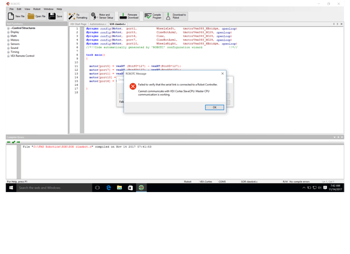

You have to plug your computer with the code into the cortex’s USB 2.0 port via included cable. You have to unplug the VEXNet key in order to access the USB port. Be sure the robot is on when you download the code! (Hint Be sure to click on the “Download to Robot” button in order to to put “code into robot”) :slight_smile:

I have tried that, but a message comes to the computer that says “Make Sure You Are Connected to a Controller” I will soon show a screenshot.
@Jacob Pa. Try updating RobotC firmware (under the Robot menu)
My VEXnet is 2.0, but the robot c is 4.0, does that matter?
Yep. you have to update firmware.
