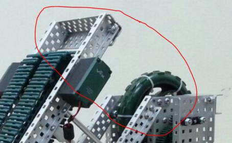

Can you share any videos or pictures?
I think it is probably the compression time. We have 4 inches for imparting energy to the ball. Is that too much? I’ll post photos soon. We are working on a reveal so you can observe the robot.

It sounds like this is a one-wheel shooter. When they say 4 inches, I think what they are talking about is the distance the ball is made to roll along inside the hood.
Looking at that launcher, there’s only about an inch of travel where the ball is being compressed. I can’t imagine needing much more than that.
The image apears to be 8059A’s robot, not their own.
yes that is not our robot I was talking about the hood.
