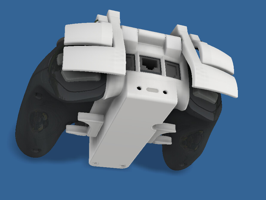

Well it’s been about a week since I’ve leeked it, and I’ve got a “functioning” prototype of my ‘V5 Controller Ergonomic Upgrade Kit’. My ideas for more (theoretically)ergonomic features quickly made it more than just a scuf controller so it’s named as such.
I was hoping to have it ready for the 2022 ‘Make It Real’ CAD Online Challenge, but I was unfortunately unable to complete the report in time so I guess I’ll have to wait until next year to submit it, but I’ll go ahead and leek it now anyways.
Right now I still have a few features to add and quite a bit more polishing up to do, but here’s what I’ve got done so far on the V1 design:
It’s got a paddle for all 8 face buttons,
A USB-C extension to the top to match the rest of the I/O ports / to protect the controller’s port,
And a holster so you don’t accidentally lose it after setting it down somewhere at a competition.
I’m not quite satisfied with it’s design so I’m going to hold off on releasing the files until it’s done, but I’ll hopefully have a V2 done within another week or so which will maybe look less like a brick attached to a clipboard, but we’ll see how everything turns out.
(And yes, you’ll be able to use a Micro-USB extension instead of a USB-C adapter if you are so inclined)

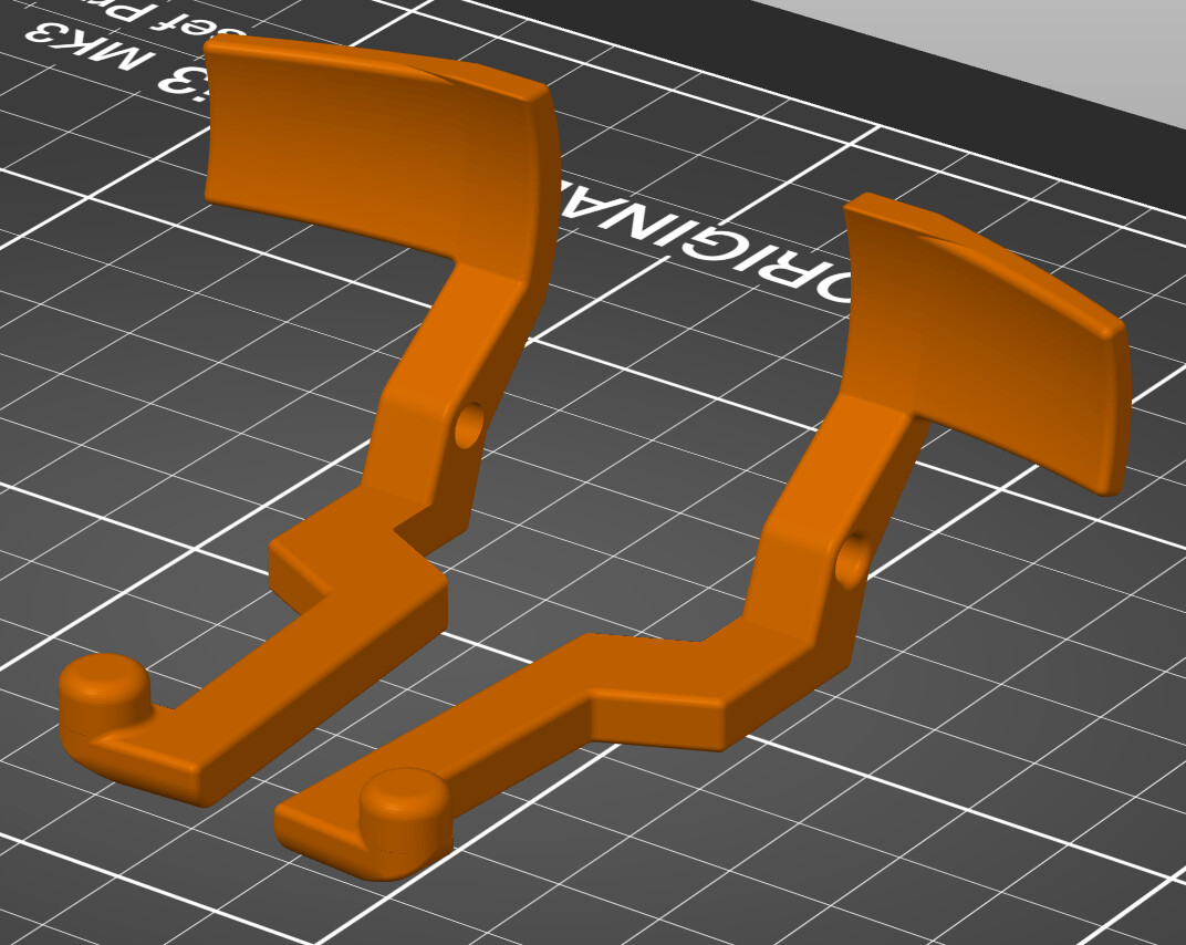

Y,Right paddles
These ones are also pretty self explanatory.
They might seem like they don’t need support material, but they do for a small cutout.
This cutout was necessary to let the washers on the screw joint have a flat surface to contact, while also keeping the angled button pusher easy to print

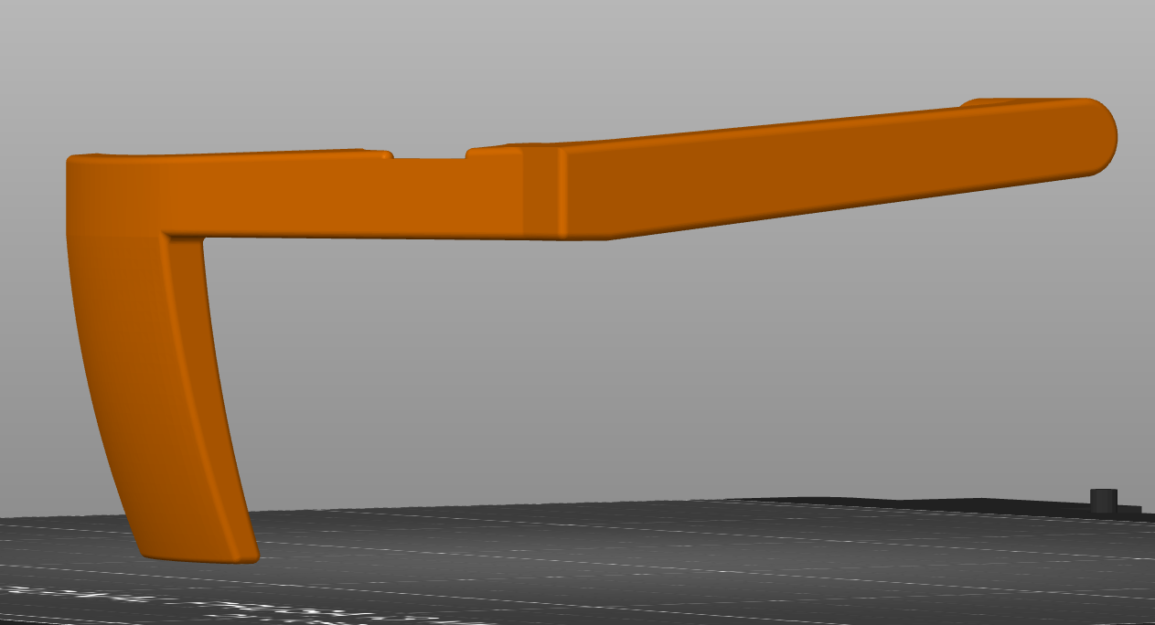

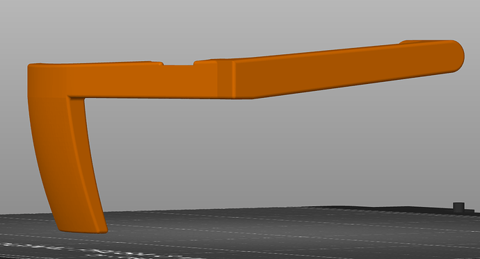

X,Up paddles
I printed these paddles in this orientation:
But you could do it like this if you wanted:
Support material is needed for both orientations.

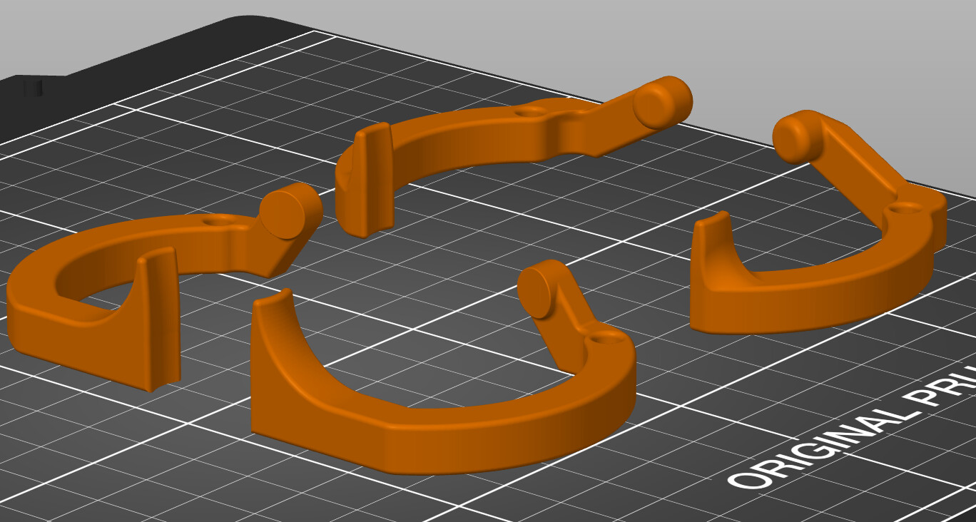

Clamshell Halves
Both halves should be printed on their sides.
Quite a bit of support material will be needed.
If you have an option that says ‘Everywhere’, then just use that. It’ll be unnecessarily supported in a couple of places, but it’ll save a lot of time placing supports manually.

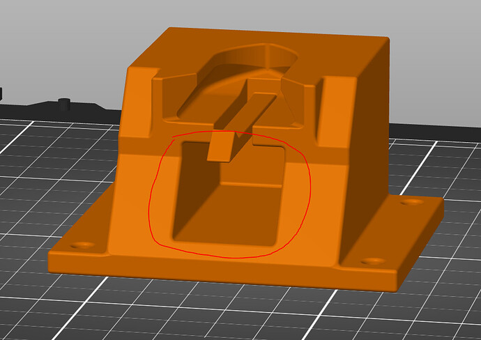

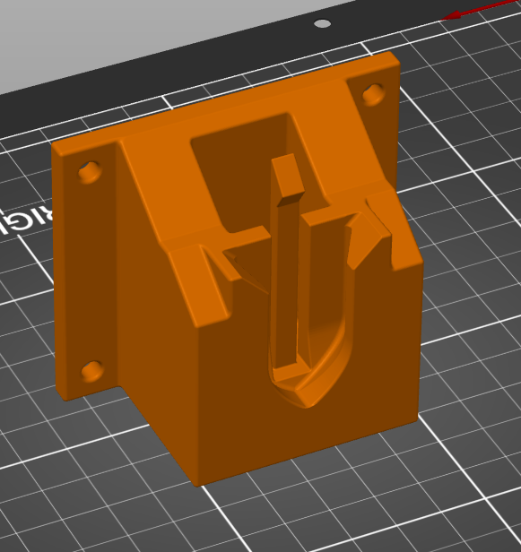

Holster Dovetail Slot Test
I printed it like this:
In which case supports are needed in the rectangular space underneath the locking arm, but shouldn’t be needed in the Dovetail Slot itself.
But I just now realized that you could place it like this if you wanted:
The locking arm might be a bit weaker, so look out for that, but then you should only need supports in the holes.

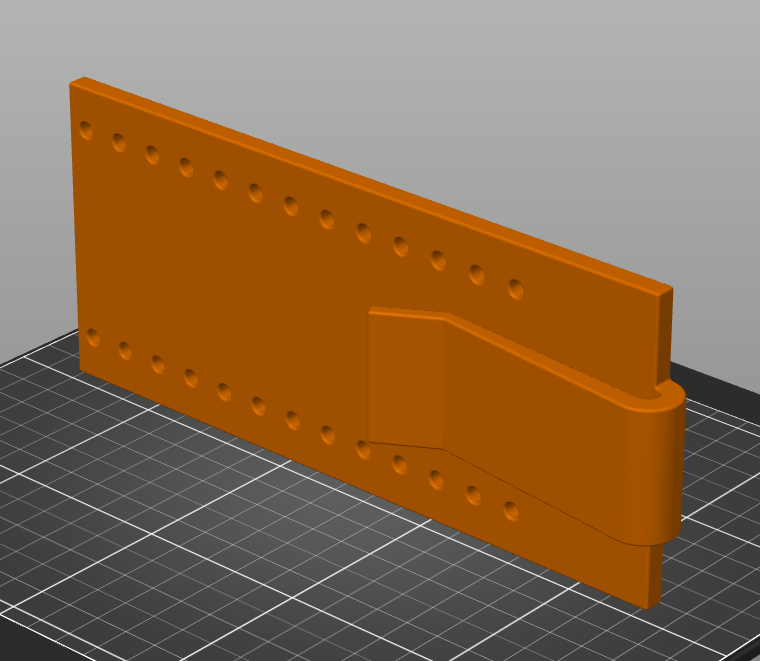

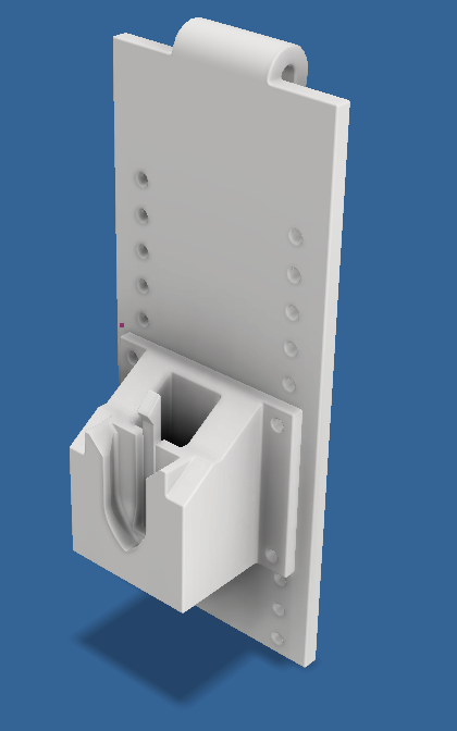

Holster Belt Clip
I really don’t recommend using this one as it was thrown together to test out the holster concept, and is pretty uncomfortable to wear.
But if you really want it, Printing it like this would be ideal for strength:
Supports are needed for the clip and the holes.

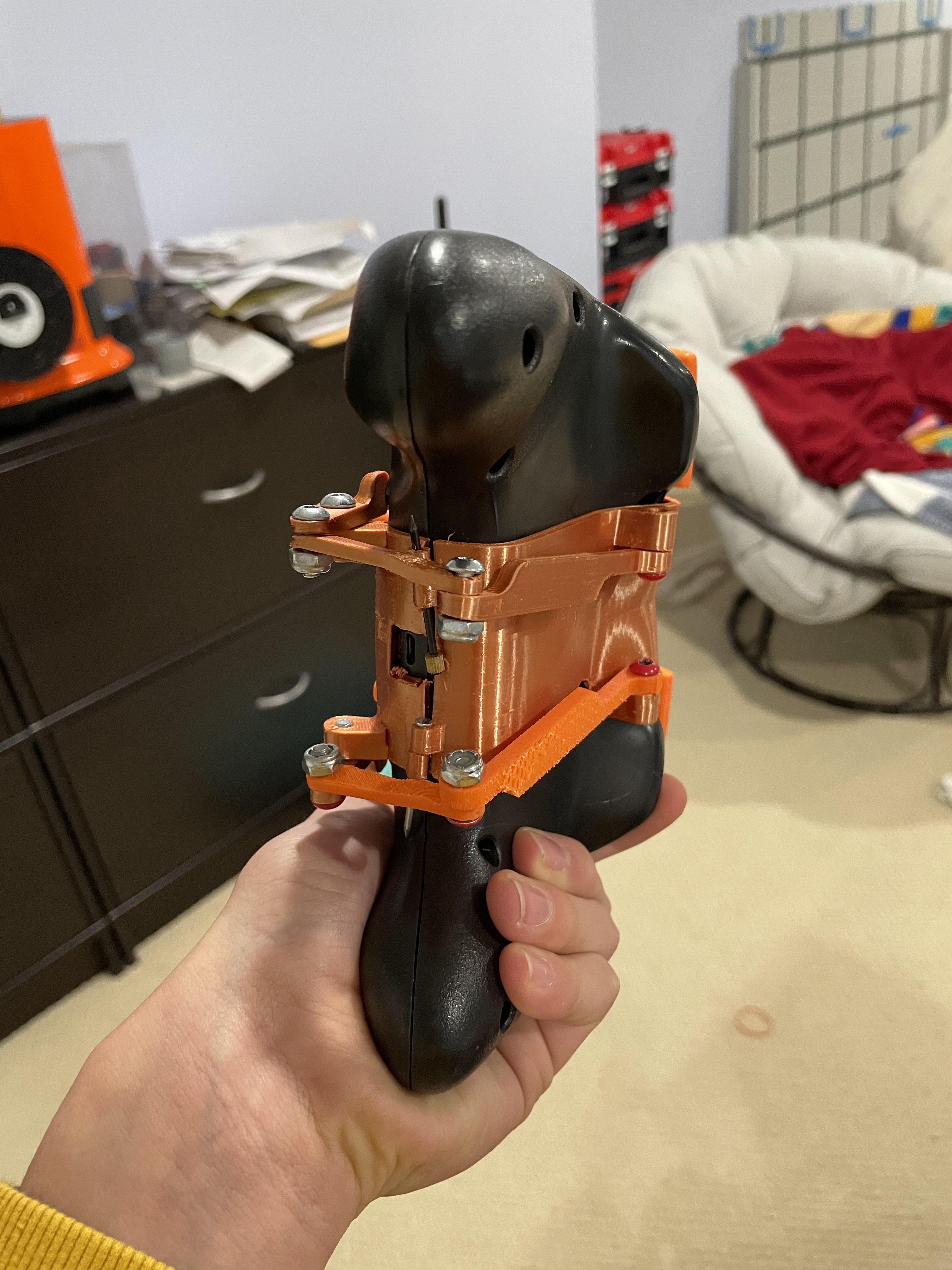

I personally used a layer height of .30mm to get the prototype printed quicker, and didn’t use any rafts on my Prusa i3 with a smooth PEI spring steel print bed, but it may be a different story for you depending on the material/texture of your print bed.
I tried to design them in such a way that they’ll use as little support material as possible (the lower clamshell half being the only exception), there is a dropdown of the recommended orientation to print the parts in my previous post.
Well I can say it works pretty well but the lower paddles seem a bit awkward to me, but I also haven’t had a whole ton of lot with it yet so it might be fine after a while.
