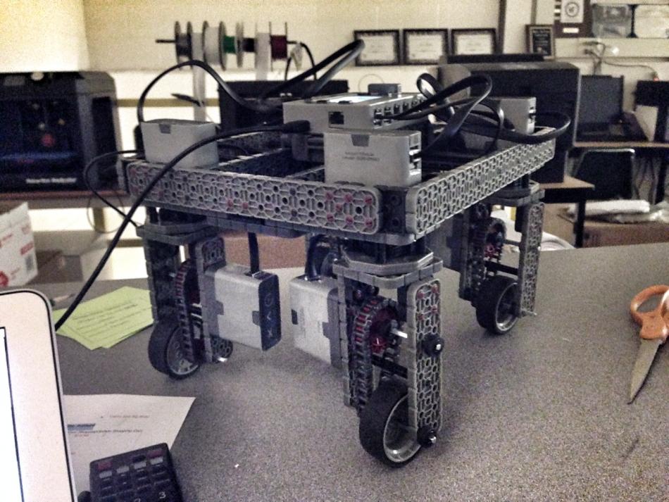

I went to write some code this morning and ModKit made me update my ModLink and install new firmware on brain/controller/etc. After updating everything, when writing a new code, I can only get 1 motor to respond at a time. If I run the “plug and play” software that’s on the Brain, motors work, but not my code, and trust me, my code is super simple just to test a few motors right now.

I don’t think that’s the problem. I have the Brain, controller, and just two motors brought in. Only the first motor I bring it responds when controlled. It doesn’t matter what port I select, as long as it’s on the first motor, that motor works via controller, but nothing else. I just emailed you my “test” code that just has 2 motors on it.

Thanks again! For others reading this the problem happened when a controller was dragged out before a motor and then you click the controller icon on the motor to “map” controller actions to the motor. This issue has been resolved and the fix has been pushed live to http://modkit.com/vex/editor. Refreshing your browser should fix this issue.
