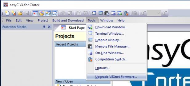

OK…We’ve downloaded the update, and still don’t understand how to update it. :confused:
The Upgrade Utility is built into easyC if that is your programming software.

Go into the folder (by default, it’s in program files and is called VEXnet Firmware Upgrade).
There should be an app called VEXnetUpgrade (the one bordered by the red square in the picture).
Double click that and that should give you the Upgrade Utility. Now, plug in your Cortex, and the Bootload button should appear around the area of the red box I inserted into the image. Click that, wait for the utility to do its magic, and boom, you have an updated Cortex.
