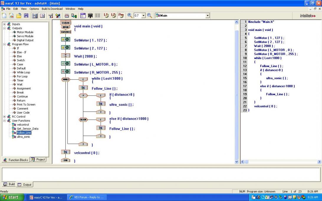

I am trying to upload easyC programs to show what I am doing and to see if anyone can help to better progaram my robot, or help program it at all.
I am trying to show my easyC program on vexforum. does anyone know how to do that?
You can copy the text-code that is to the right of the program, (if I remember correctly) CODE ] and paste it in here CODE/ ] (without the spaces in the tags). Or, you could take a high quality screen shot, but I would suggest doing the first.

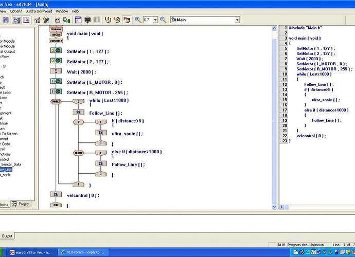

test at uploading jpg of my code [ATTACH]3379[/ATTACH]
A good start, but now we need to see the Code for [FONT=Courier New]Follow_Line()[/FONT] and [FONT=Courier New]ultra_sonic()[/FONT].
Also, posting the Code verses a Screen Shot means that it takes less time to re-write or edit what you have. If I have to retype your code, it might be a while before I get to it. Other people might have more time to re-type it, but then you limit your assistance to a smaller number of possible people.
