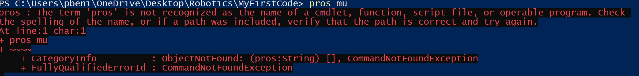

This is the project folder I’ve been using to create a basic driver control. I used the pros “new project” tab to create it. I opened up powershell and typed in the command and it still didn’t work
What error did it give you?
VexForum_MyFirstCode
You need to install the PROS CLI. there is a great tutorial on https://pros.cs.purdue.edu
ignore what Drew said, the issue is that the command has to be prosv5 mu not pros mu
I tried with prosV5 mu and nothing showed up and the program didn’t download onto my v5.

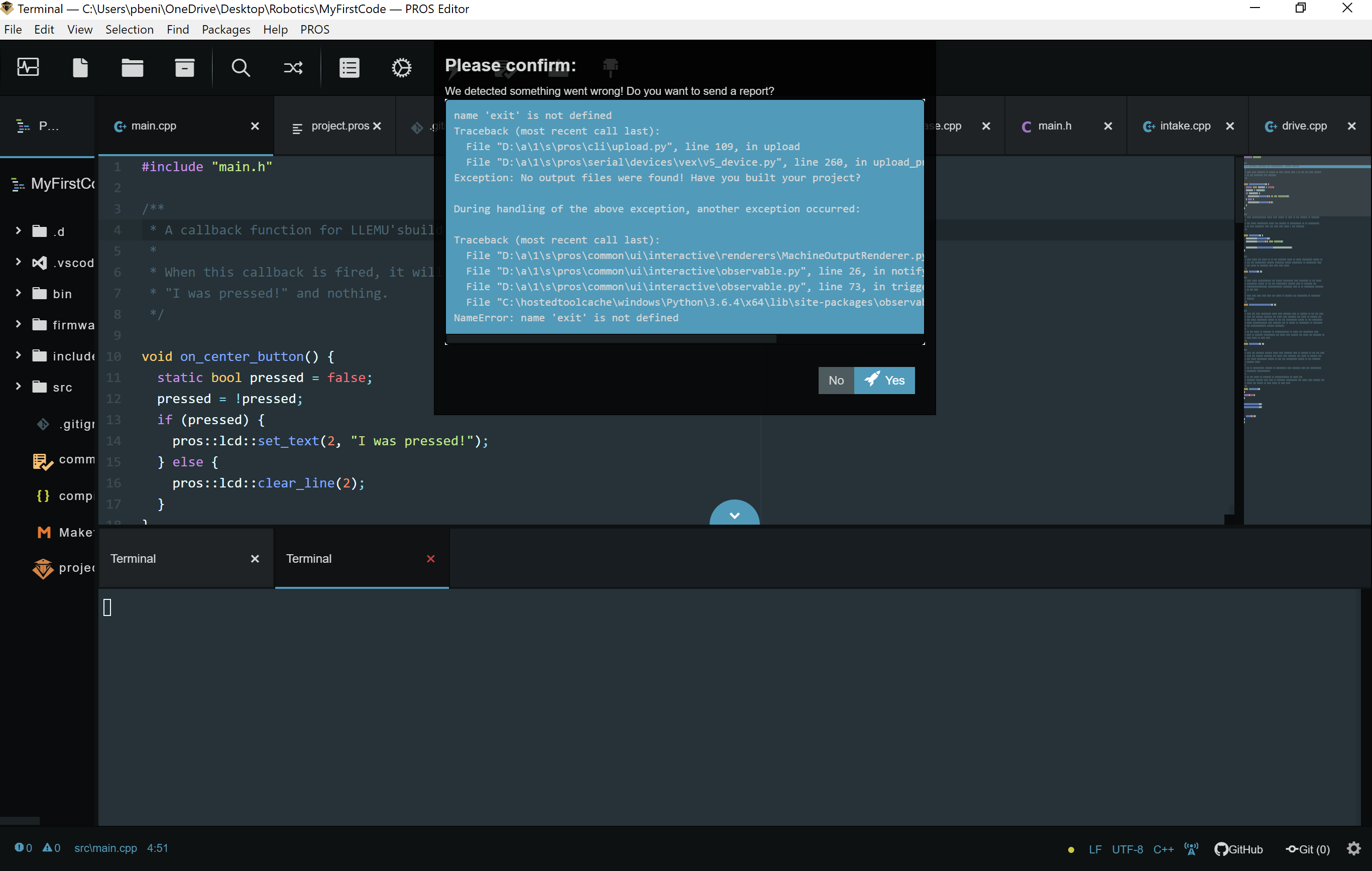

Yeah, I’ve figured those buttons out but whenever I press any of those three buttons the terminal comes up blank and doesn’t upload or build.
I’ve also managed to get an error that says “exit” is not defined
screenshot?..
doesnt seem like anything is wrong with your code, maybe try reinstalling pros?
Edit: reopen the pros installer and there should be an option to repair the install
I’ve repaired it and created a brand new file. It still isn’t working though, but I had to create a new file after the repair and now I’ll be copying the code over and send in an update later.

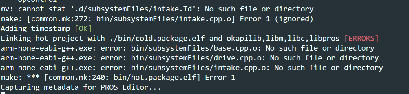

Repairing the PROS installer fixed a lot of issues and is letting me use the three buttons at the top. This is my new error code that I receive, but at least now it is attempting to download.

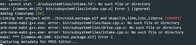

Second error code that I don’t know they they relate together.

you are missing the filesimage
or you changed the names of the directory or file
@Beter
You need to post the whole error (you only got the bottom). It looks like you have a compile error, which prevents the object files from building. You won’t be able to upload until you fix the compile errors.
Ignore all the errors given by your linter (thing that gives errors without compiling/builder). It can easily get confused and gives wrong errors.
Another idea, make sure your entire project path does not have spaces in folder names.
@natewu, that is not the problem. The linker is looking for object files that the compiler spits out, to combine them and make a binary. Since the compiler failed, the linker does not have access to said object files because they don’t exist.

Thank you for the help I was able to fix the problem. Reparing PROS and making a new file afterwards fixed most of the problems, time to finally start learning some new stuff.
