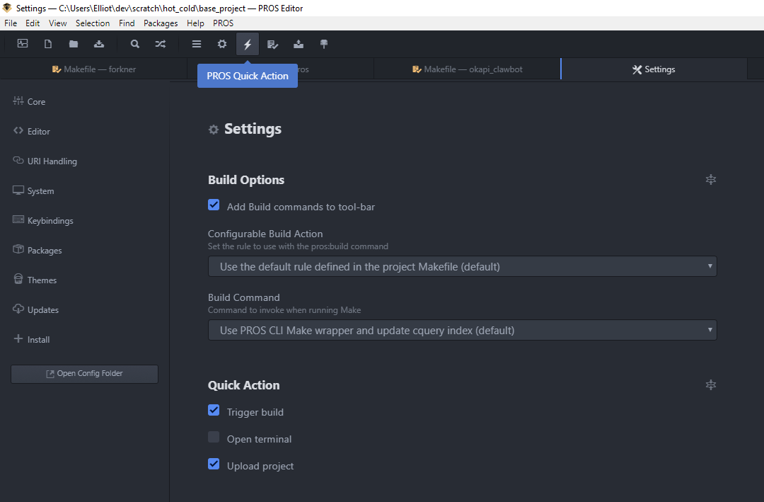

Ah, it was rebuilding that I forgot to do! Thanks for that, I suppose I’m just used to VCS doing that for me prior to uploading. Is there any chance that this “auto-build” feature would be implemented into PROS?
PROS Quick Action (the lightning bolt on the toolbar) is configured to build, upload and open the terminal with one click. You can just do build/upload by opening the PROS package settings and unchecking the terminal action.

Thanks! I’ll be sure to use this in the future.
