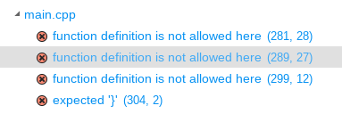

 while(true){
    if(Controller1.ButtonA.pressing()){
      endgame2.set(false);
    else{
      endgame2.set(true);
  wait(5, msec);
    //pneumatics
    if (Controller1.ButtonY.pressing()){
      endgame1.set(false);
    else{
      endgame1.set(true);
  wait(5, msec);
    //pneumatics
    if (Controller1.ButtonX.pressing()){
      shooterthing.set(false);
    else{
      shooterthing.set(true);
  wait(5, msec);
      }return 0;
void VEXcode_driver_task() {
  // Start the driver control tasks....
  vex::task drive0(ondriver_drivercontrol_0);
  while(Competition.isDriverControl() && Competition.isEnabled()) {this_thread::sleep_for(10);}
  drive0.stop();
  return;
void VEXcode_auton_task() {
  // Start the auton control tasks....
  vex::task auto0(onauton_autonomous_0);
  while(Competition.isAutonomous() && Competition.isEnabled()) {this_thread::sleep_for(10);}
  auto0.stop();
  return;
int main() {
  vex::competition::bStopTasksBetweenModes = false;
  Competition.autonomous(VEXcode_auton_task);
  Competition.drivercontrol(VEXcode_driver_task);
This is my code. It used to have 3 loops in the pneumatics section, and only one of them would work (working solenoid, cord, etc.)
A senior teacher at my school checked it and had me remove the loops, making it only one.
It stopped working.
I made it not loop at all, and it still did not work.
The teacher doesn't know what's wrong, and says there seems to be a problem with the bits I didn't write (automatically filled in) (started by making blocks code, just putting in an autonomous hat block and a driver hat block, then switching to c++, thus making a template). I have not edited the pragma, functions, or the stuff that comes after the driver code.

I did that. Now it gives me an error.

Now you have a second while (true) inside of your outer while (true), which is stealing the closing bracket of the function this is defined in. This means cpp thinks you are defining functions inside of functions, which isn’t allowed, hence the errors. When the error checker reaches the end of the file, it realized it hadn’t found the closing bracket yet, and gives the error expected '}'. All you have to do to fix this is to remove the second line that says while(true){.
