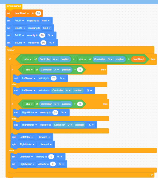

Hi, We are using Joystick A for Left Motor and Joystick D for Right Motor. Would like to reduce the speed to say 75% of max. This is the code that we are using. However, this is not allowing the motor to go in reverse when we move either joystick back.
vexcodeiq_madele1_11092019
If you barely move the joystick back, not more then 75persent, but more than 25 percent back, does the motor move backwords?

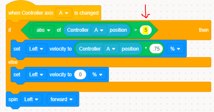

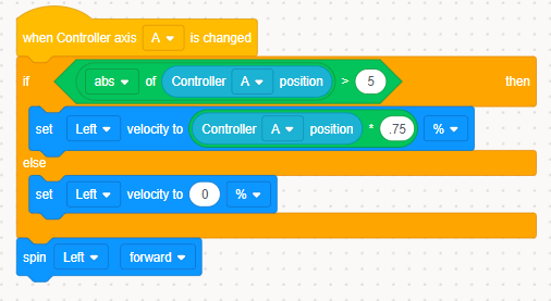

Just multiply the value of controller A and D by .75.
A deadband of 25 is pretty big.

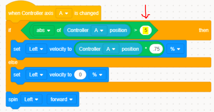

This would set the left motor to 75% of max power of Axis A with a deadband of 5.
That works, and we used it last year. The only problem is they might have code planed but not implemented, that needs it in the format it was in. Also I did not want to suggest a huge change,.
@LarsonVex Also, if you need to change the dead band, change this number.
Then make another copy of this code for the right side.
