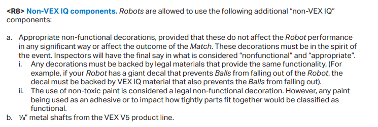

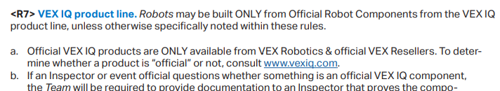

We want to use regular string (not specific vex string as we dont have any) in our robot. Is it allowed? We have ensures the way we use it that it will not become entangled in anyway.
You can find the manual and all the information you need to start here:

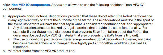

Note <R7> and <R8>:
I don’t see anything that shows you would be allowed.
