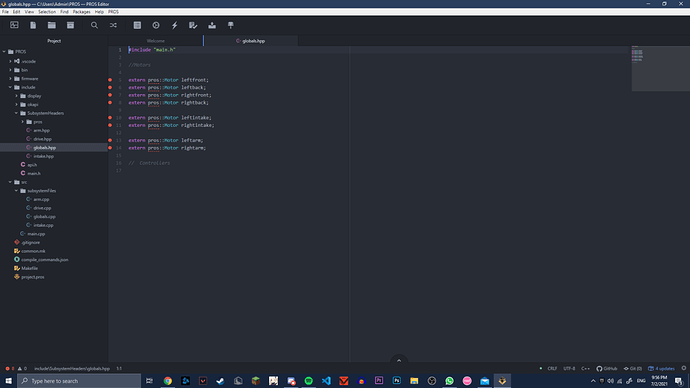

Use of undeclared identifier 'pros'
Kinda anti-climatic first post on the forum but when I extern motors in my globals.hpp file it gives me an error saying this:
error1
Any idea on what I should do? I’m trying to self-learn PROS myself, trying to transfer from VEXcode Pro V5 to PROS so I’d appreciate the help.

Hmm I’ve already included the main.h in my files but it still gives the same error. Anything else worth trying? I’ll attach the code underneath for ya.
And from the tutorial I watched there were separate files for opcontrol, autonomous and initialize but the project that I started up complied those 3 files into main.h. Is that normal or do I fix that too?
You probably should not move the default pros directory into a user added directory (SubsystemHeaders in your case) because it breaks every single include that references it. For example you will see:

This means that an include which looks like #include "pros/myHeader.h actually resolves to a complete path that may look like /usr/documents/pros-project/include/pros/myHeader.h. By moving the pros directory into a user defined directory, you are moving a bunch of important files into an unknown location. You could fix this by updating each relevant include to say #include "SubsystemHeaders/pros/*.h, but please do not modify any of the provided pros files. I am just trying to show you an example of how it works.
TL;DR you need to remove the pros directory from SubsystemHeaders and place it directly in include.
Once you replace the folder’s location you should build the project and those errors will go away. (You can use the quick action button to build the project) Those errors usually show up the first time someone opens a pros project and hasn’t built it yet. If you have done everything else correctly you should no longer have any errors.
