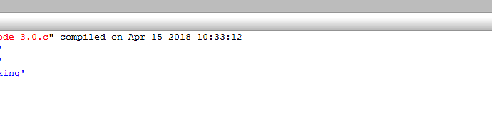

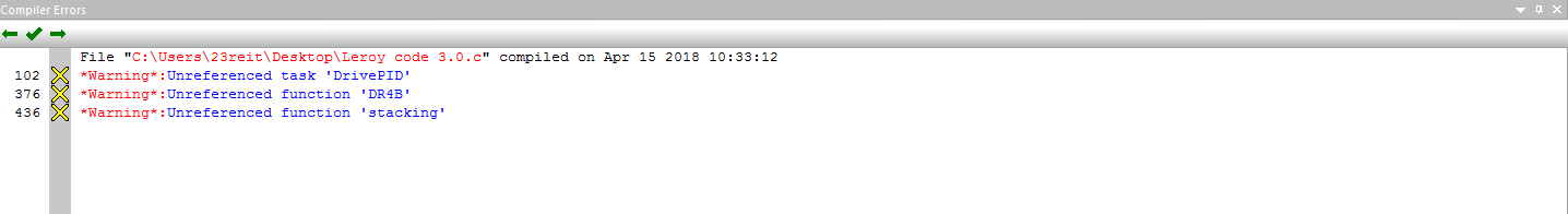

These are the compile errors. Its just that I didn’t use the PID yet…
