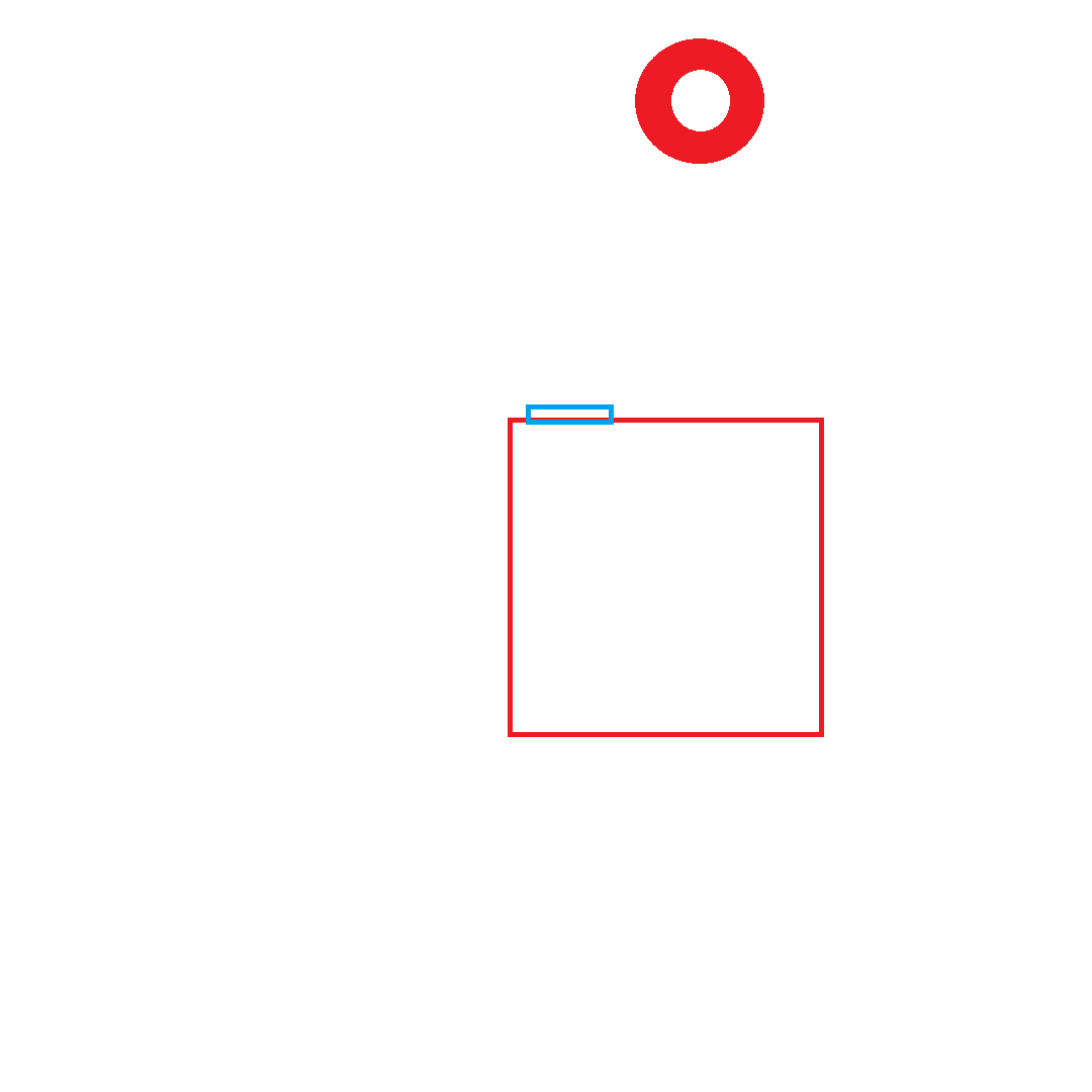

Hey. I was wondering if anyone could help me understand how to go about researching the math behind and coding an unaligned vision sensor on our robot. I am pretty sure it is possible but I don’t understand the math to start it yet. Let’s say our robot vision sensor is 6 inches to the left of the center of our robot.
I understand that we have to use an offset and most likely trigonometry, but I don’t know where to find this information. Can anyone offer links or resources to help me?

As helpful as a long description is, you’re still missing some details, like do you want the angle to turn the robot to face towards the object? Do you have a holomonic drive that can move anywhere? Regardless, here’s the math
D: Distance from the robot to the object (measured by distance sensor).
L: Lateral offset of the sensor from the robot’s centerline.
θ: Angle between the object and the sensor’s line of sight (I’ll show the math after this section).
X: The lateral shift you need to make to center the robot in front of the object.
Since the sensor is offset by L, you need to calculate the lateral distance from the robot’s centerline to the object using the angle θ provided by the sensor.
The lateral distance X is given by:
(This is the hardest trig part you wanted)
X=D × tan(θ)
Since the sensor is offset by L, you need to add or subtract this value depending on the configuration (whether the sensor is on the left or right of the robot’s centerline). Assuming the sensor is on the left, the required lateral movement C to center the robot is:
C = X − L
Move the robot laterally by C to center it in front of the object.
Example:
If the distance sensor reports a distance D = 2ft and the vision sensor an angle of θ = 30°, and the sensor is offset L = 0.5ft to the left:
Calculate the lateral distance from the robot’s center to the object:
X = 2 × tan(30°) = 2 × 0.577 = 1.154ft
Correct for the offset:
C = 1.154 − 0.5 = 0.654ft
The robot needs to move 0.654 ft to the right to center itself in front of the object.
