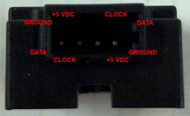

Looking at the 4 Wire Cables that came with my Motor Encoders, and using the Pin Outs for the Cortex, I made a Diagram for the Motor Encoders.
4 Wire Cable is White, Yellow, Red, and Black.
       Cortex         Color           Encoder
        DATA          White            DATA
       CLOCK          Yellow          CLOCK
       +5 VDC          Red            +5 VDC
       GROUND         Black           GROUND
Since all the Motor Encoders should be Identical, and can be directly connected to the Cortex, ALL their Pin Outs should be Identical. Since the Cable Crosses Over, the two Connectors on the Motor Encoders will be Pinned the Opposite Direction.
[ATTACH]7098[/ATTACH]

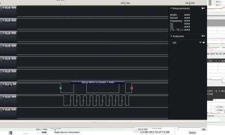

I’ve also attached exactly what happens to the lines when sending that i2cset command, if that helps.

The logic analyser trace shows that the IME did not respond with an ACK to the address which was sent. As i2cdetect did not find the IME that’s not surprising so get i2cdetect working first. Is the IME orange led on? Are you connected to the input side of the IME, this is the input with pins, the lower input on MarkO’s picture?
There is a small chance that you need to use address 0x30 (0x60 >> 1). The i2c address is 7 bits, some code assumes that it is packed in the upper 7 bits of an 8 bit byte so all that has to be done for reading is to logical or with 0x01, other code thinks it is in the lower 7 bits and has to be shifted first. i2cdetect should help with this, it is most likely 0x60 but if i2cdetect shows a device on 0x30 then that is what is happening.
Where did you monitor the i2c lines for the analyzer trace you posted?

You’re right - the screenshot I posted on the logic analyzer was actually at 0x30 (I tried multiple addresses, and that one matched 0x60). I showed 0x60, but tried both.
They were on the RPi outputs, not the encoder inputs. That would’ve shown my problem!
