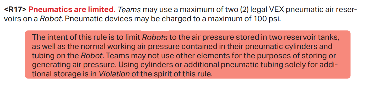

You may not use pneumatic tubing to provide increased reservoir capacity.
I suggest you re-read what is permissible in the Game Manual.

This would not be allowed by R17

Wow I don’t know how I missed that. Thanks for the help. I was hunting for the rule as you sent that. I might delete the post because it’s clearly useless.
No worries - this is well established, and hard to use search bar for past seasons.
[edit - do keep post as it will help other teams with similar questions]
