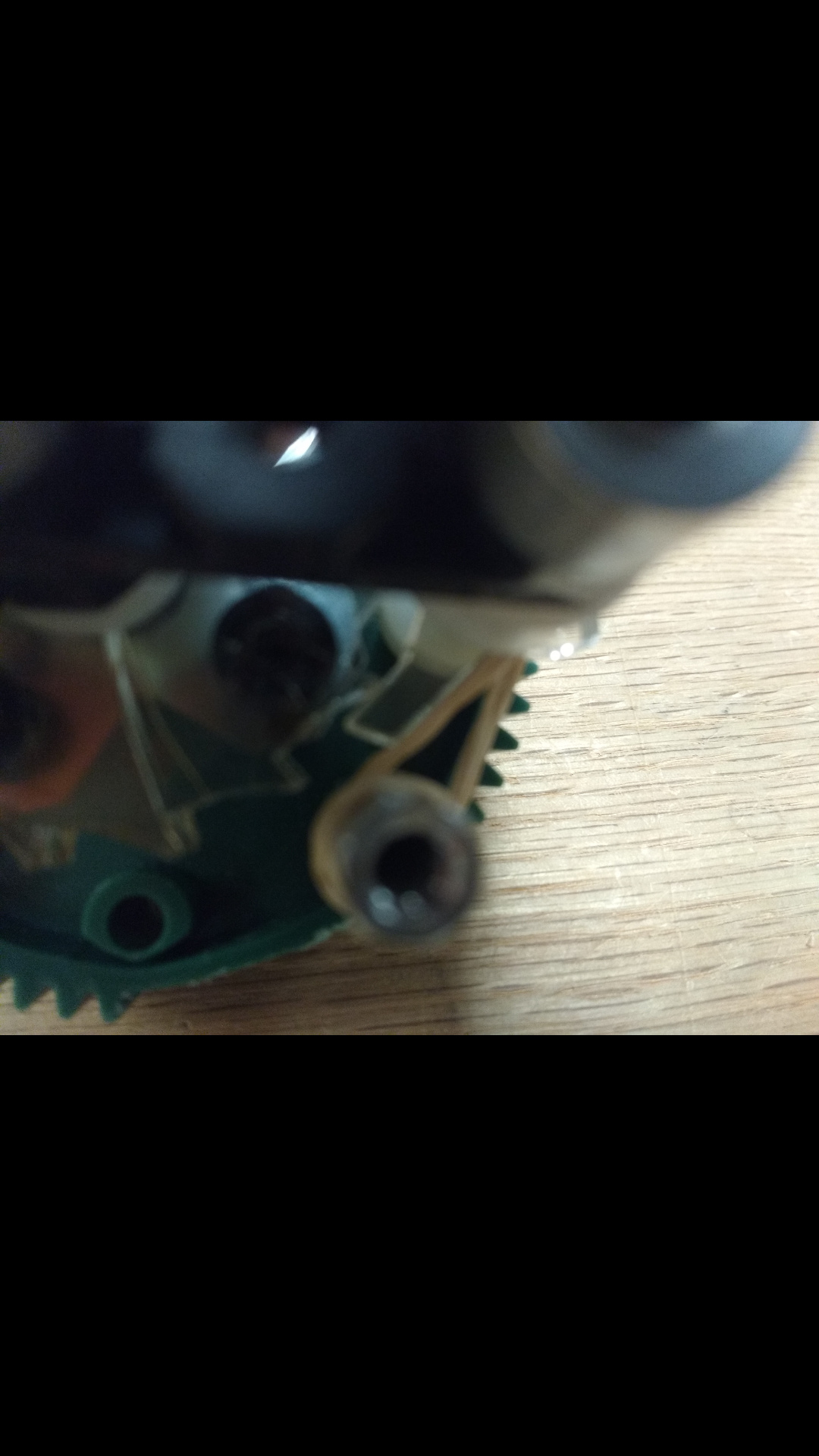

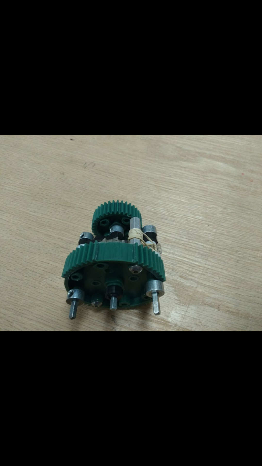

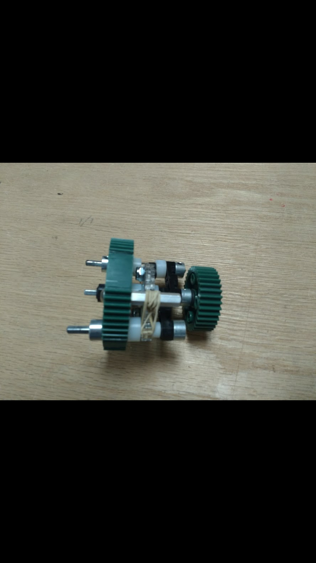

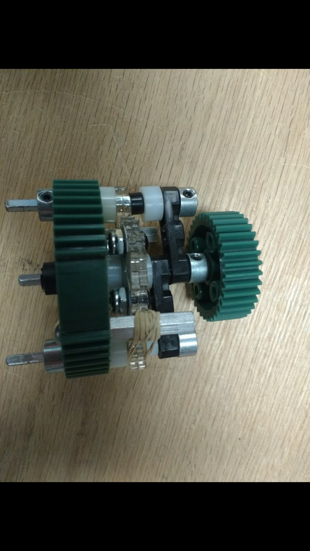

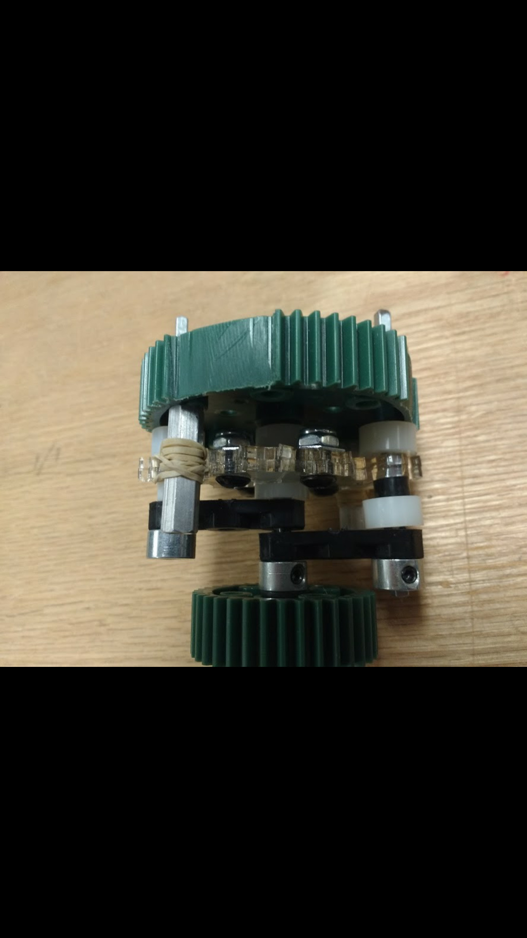

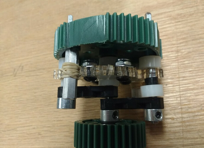

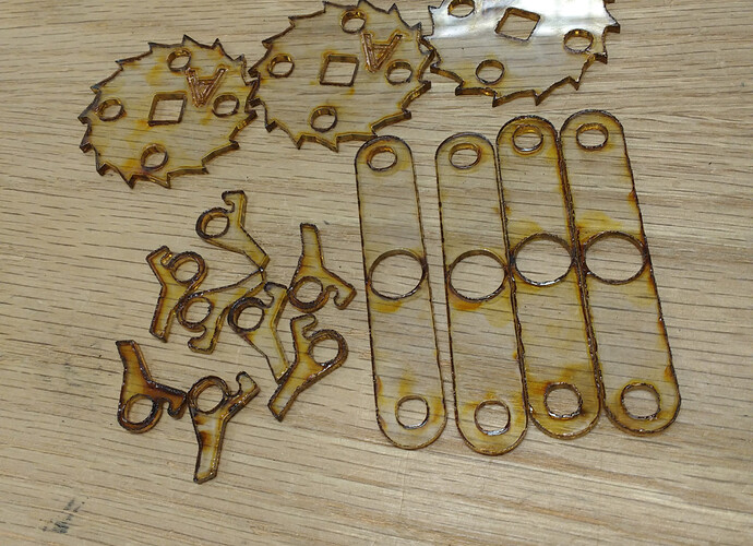

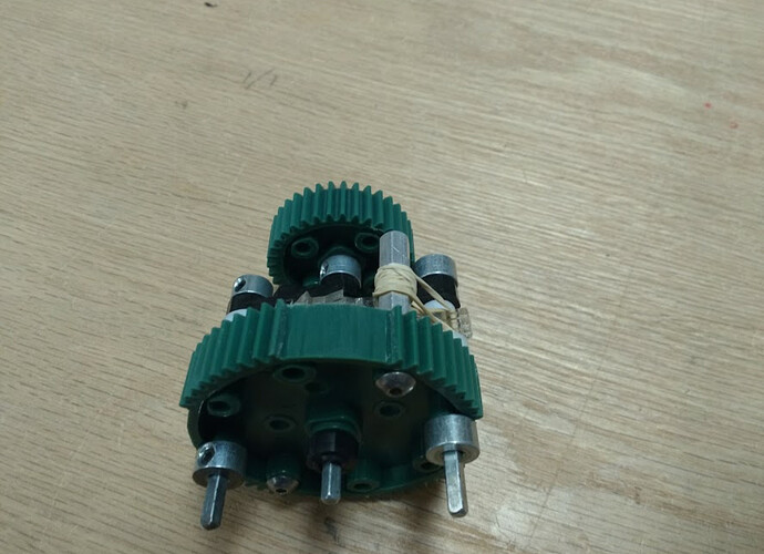

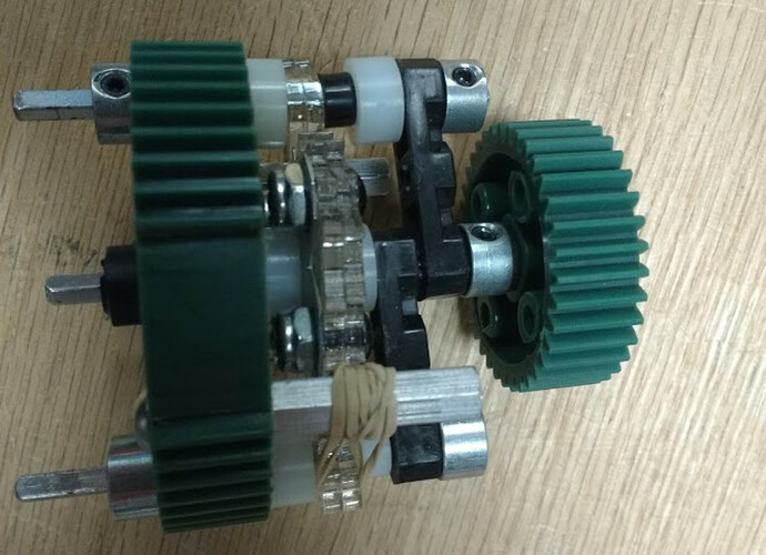

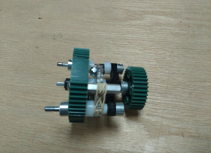

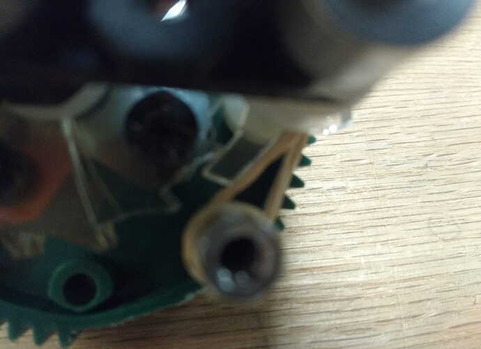

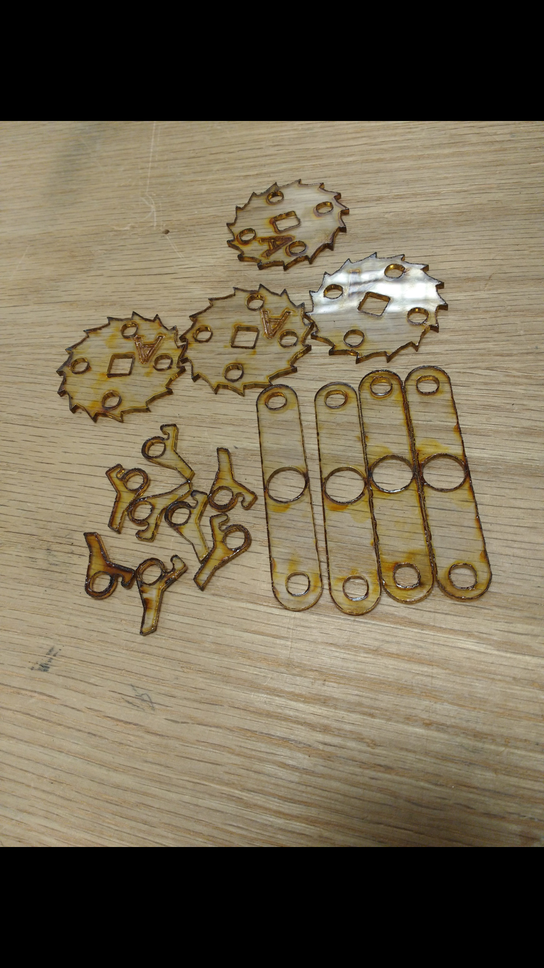

Here are some pictures of the parts we used. We cut them out of plastic. The idea is to put the smaller clicker pieces on axles right next to the gear with rubber bands, so that when the gear spins one way, they will lock with the gear, and when it spins the other way, the clickers will slide over the teeth. These are the best pictures of the mechanism that I have.
Wow, that is cool but also kinda overcomplicated if you ask me. I literally just have a piece of lexan pressing on the teeth of the at an angle and it works just as well, if not with higher resolution. But whatever works for you…
That is essentially what we are doing, just in a more complicated way, as you said
