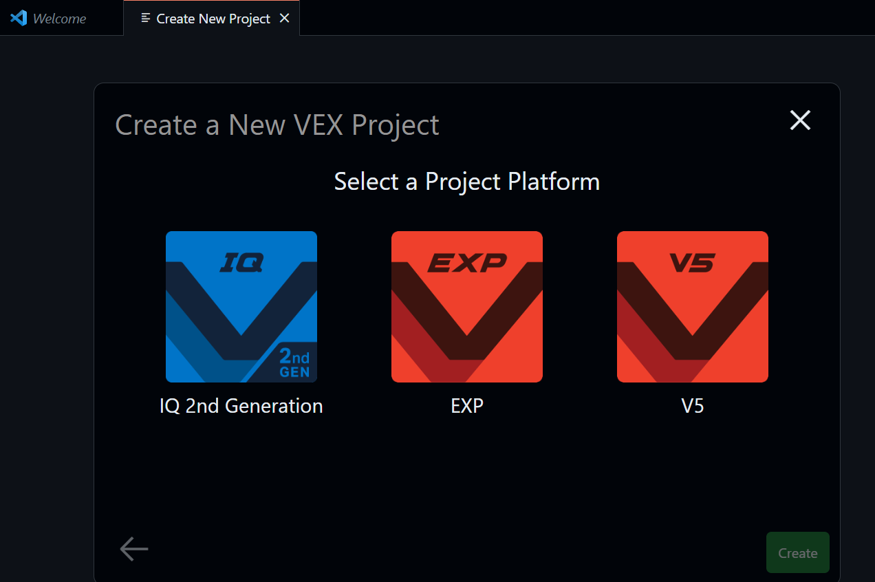

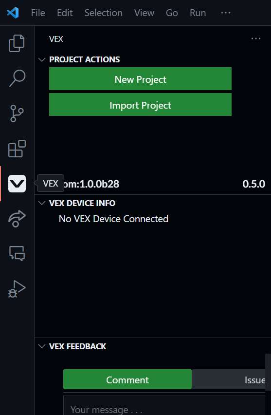

start by clicking the vex extension on the left
then click on new project

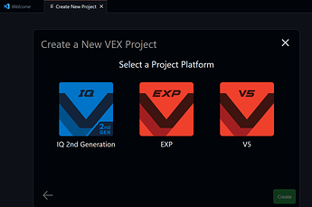

choose the options that fit (most likely v5 then C/C++)

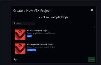

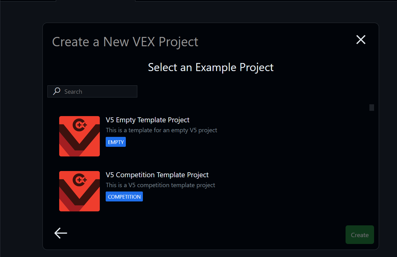

here is where you can search for examples and templates. Alternatively, you can also import templates from vexcode pro v5 using the import button.

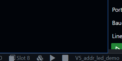

as for vex.h not being recognized, this is usually the result of not importing properly or not having the correct parent folder open causing the vex extension to not activate. You can check if its activated by checking the bottom left corner for these icons.

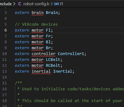

I created a new file, but I’m still getting error squiggles (include error) for math.h in vex.h
I might have just forgotten to import vex or something. How would I check if the file has the required vex files?
image_2024-01-10_100502375
This is why I think that (the math.h error squiggles went away at least for now)
There are templates for Python, but only a few and the competition template doesn’t seem to be one of them. i was able to import, but now running into import errors.
i tried to enter a comment/issue for this, but i got an error on the comment and issue submission…
