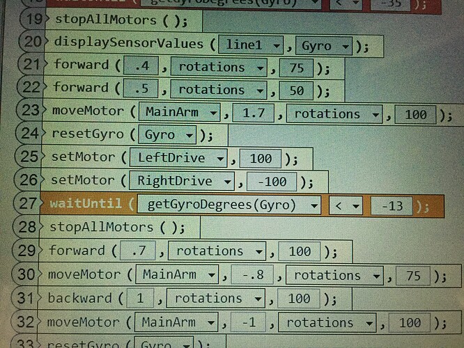

This is a sample of our program where we make it pick up one green cube, turn and place it. It sometimes overshoots the turn but the main issue is the robot goes the .7 rotations and does a sudden turn that’s not in the code like the one I mentioned earlier.

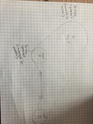

Here’s a description of our chain drive.
OK, so looks like this is a tank drive system, and your bot must drive pretty quick! Are you using rubber wheels or omni wheels?
Also, have you turned “holding” off on the drive motors?
As @Sarge mentioned, you want to set your brake mode to brake stop instead of brake hold. What’s happening is due to the slack on your chain, the different amount of slack between the right and left side chains. Brake hold will lock the motors and any slack will cause the robot to turn or move back.
I haven’t seen a set brake mode command in RobotC graphical. But in RobotC text, it’s simply
setMotorBrakeMode(LeftDrive, motorBrake);
setMotorBrakeMode(RightDrive, motorBrake);
However, when you are using something like a moveMotor motor command to a specific number of degrees or rotations, once the motor has reached that distance it will apply motorHold. So, you must immediately after that command put in setMotor(LeftDrive, 0) so it puts in the stop command, which will allow the motorBrake to take affect.
