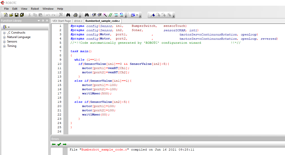

When I first received the kit, I was able to turn on the controller and transmitter and it actually worked just fine! It was only once updated the firmware on the PIC controller and uploaded my own RobotC code, that suddenly the transmitter could no longer communicate with the PIC controller. My code includes sensor-based motor commands (like, if a bumper switch is pressed, move motor 1 forward) and those functions are working just fine on the robot, I just can’t get the transmitter to communicate with the controller.
I am using the code “motor[port1]=vexRT[ch1]”

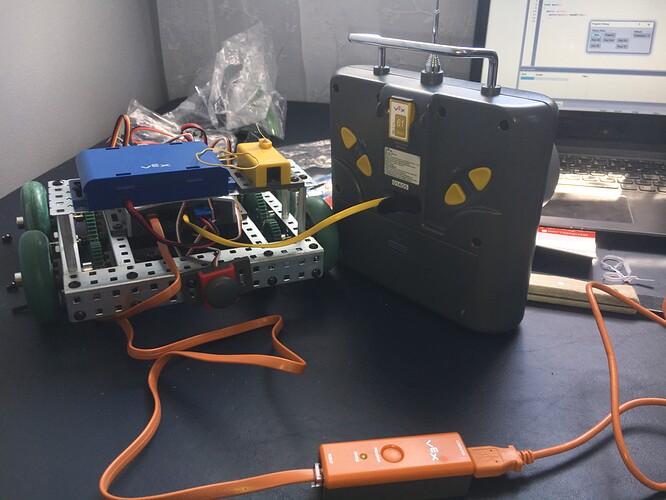

And I even have a tether cable I can hook up between the controller and transmitter, but still no control, even though the rest of the code clearly works because the motors respond to sensor input.

@Eli_Osornio this is the post I made relating to my transmitter not working with my PIC controller.
It looks like your sonar sensor isn’t doing what you want. It has to have a value of 5 for it to move.
If you change the line with the sonar to
if (SensorValue[in1] == 0 ) {
does that let you drive the robot?

I am a little confused though because in my code I wrote “if(SensorValue[in2]>5)” so I thought that means if the sonar value is greater than 5, not equal to 5.

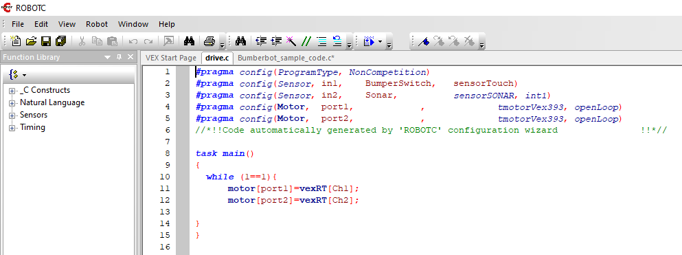

Something I did try yesterday was this code shown below. It also did not give me any control from the transmitter, even when directly tethered!

OK, so that sample code with the driver stuff was my next choice for you to try.
Just to confirm that the sensor code works. So
if (SensorValue[in1] == 0) motort[port1] = 100;
has the motor move when you press the button?
I’ll need to dig around for the PIC version, this PC only has the Cortex one.
@Foster , Okay, I tried your code, and yes, when I push the button the motor does turn.

Can you try setting
bIfiAutonomousMode = true;
or maybe
bIfiAutonomousMode = false;
There is a feature that if the the robot doesn’t see the transmitter it stops moving and I think this overrides it.
you have just made my day!!! the code below worked!!!
