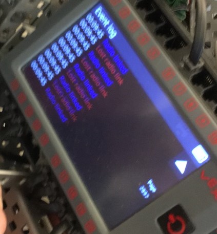

Hello, at the competition today 1320C had a very odd issue in the finals match. Midway through driver control, their robot stopped functioning and the remote screen started flashing red. The robot didn’t function for the rest of the match. After the match, we checked the error log. It was continuously spamming the following events. (sorry for the bad picture)
Over the space of about 5-10 minutes, it generated about 3,100 pages of those two events. After power cycling, the issue disappeared. Does anyone have any idea what could cause this? I would greatly appreciate some help as this may have determined the outcome of the finals.

@PlacerRobotics Were you getting the same events in the picture dozens of times a second?
not that I remember.
did this happen even after brain power cycle ? do you mean slow to start a program ? or just going into devices screen or something ?
No - the event log had discrete occurrences that corresponded to what happened on the field (started auton, disconnected; reconnected in driver mode, then disconnected several times).
