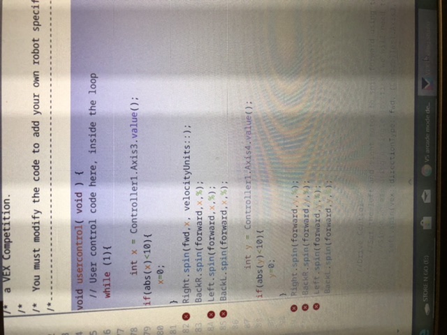

I’m pretty new to coding and basically been learning and experimenting from the sample codes. This is all over my head. Some solid examples would be great.
int x = Controller1.Axis3.value();
if(fabs(x)<10){
    x=0;
Motor.spin(forward,x,percent);
This basically gets the value from the joystick and checks if it’s less than 10.
If it’s less than 10, set the motor to 0.
If it’s greater than 10, run the motor at the joystick value.
Basically make an int for every joystick, check each joystick and incorporate the variables into the Motor.spin
Where does that particular code would go before or after on the drive code?
It would go before because u want to check if it’s less than 10 before giving power to the motor

ok, here is an example valid for VEXcode.
VEXcode simple arcade control with deadband

For the last parameters in the .spin commands you need to put velocityUnits::pct and not % or velocityUnits::.
