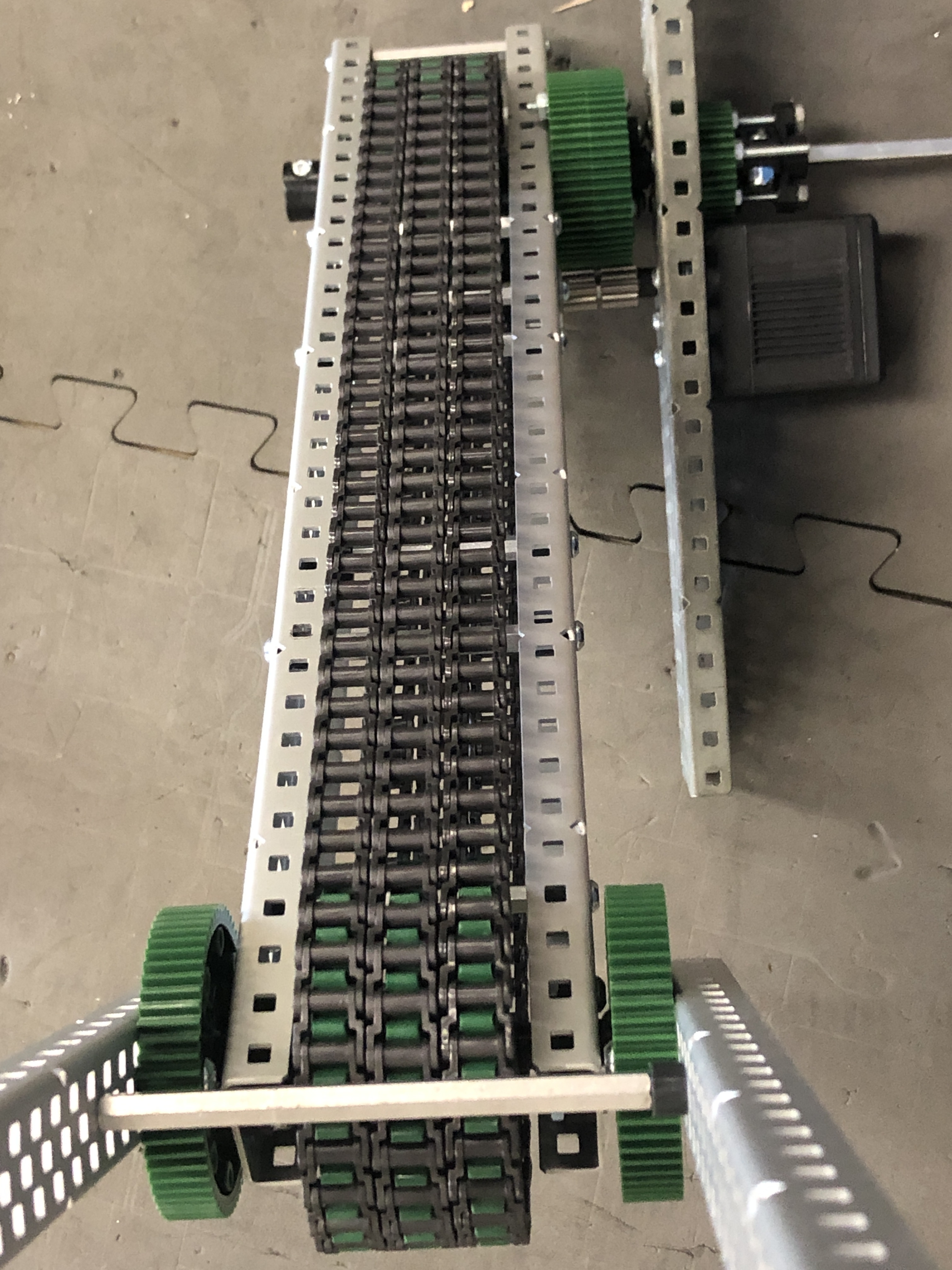

This is a pic of the chain bar Bicep for their competition arm.
