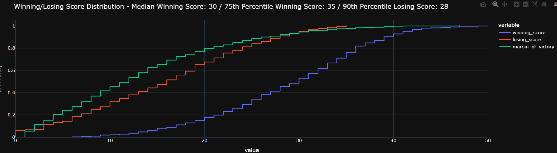

The median winning score is 30 and the median losing score is about 15, and the median margin of victory is between 11 and 12, meaning half of matches could have been swung by auton.
I’d argue for auton dropping down to 4 points.

I agree with all of you, but just a reminder: correlation is NOT causation.
The auton and win correlation could be because of a third factor, such as the fact that teams made a good robot or practiced much also had a good auton.
