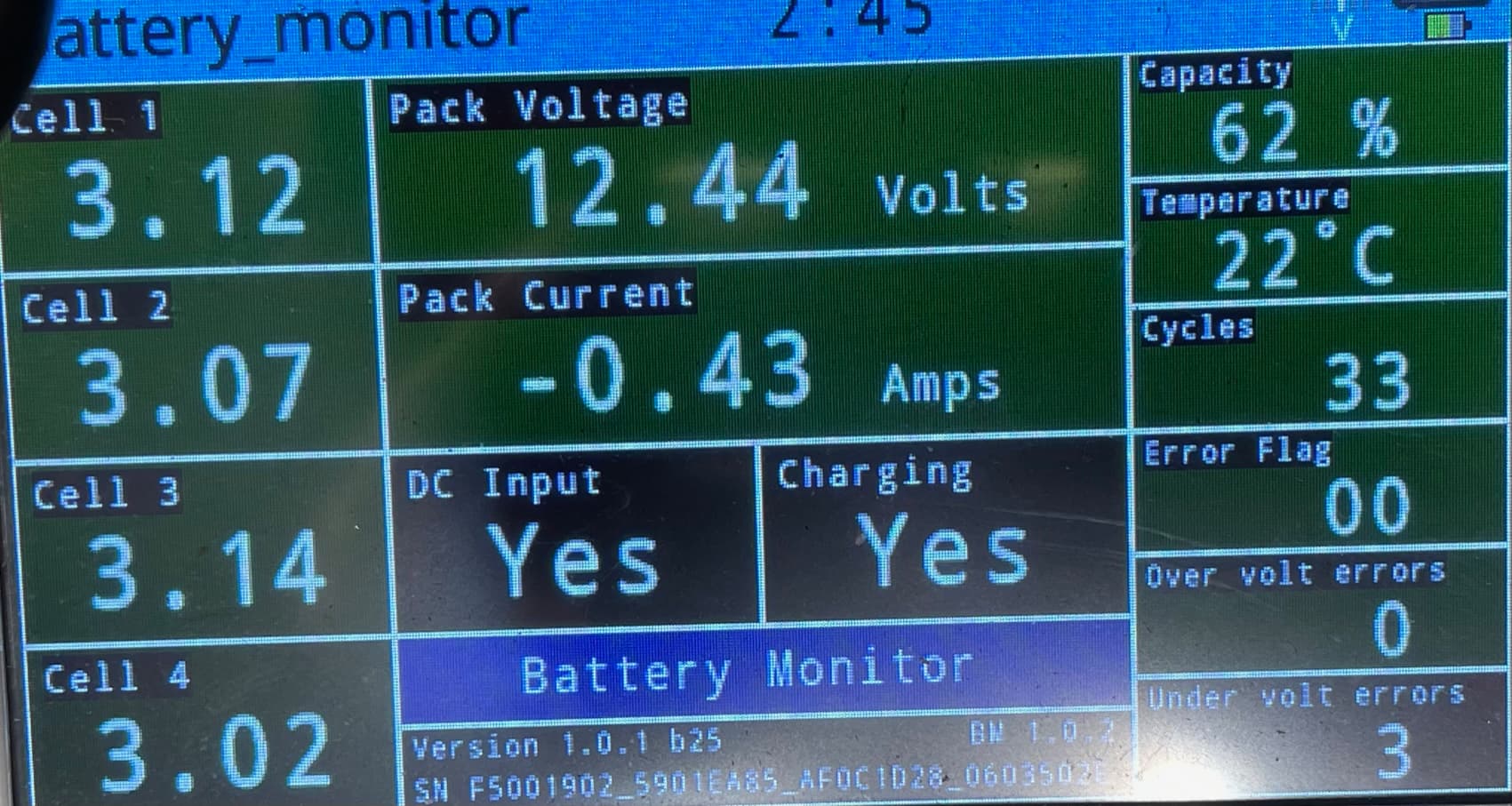

@jpearman thanks for the suggestion! Attached is the battery medic screen. It shows undervolt errors, but all the cells are about the same. Given the undervolt errors, is the battery a lost cause?

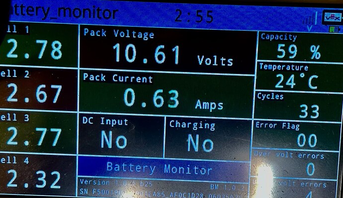

Off the charger, it took a few minutes for it to die. The cells degraded about the same, cell 4 the fastest, but cell 2 also went red before it shut down completely.
No, let it discharge on the brain and see what cell voltage is just before it turns off (ignore capacity for now).

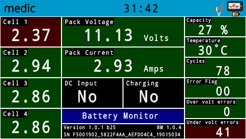

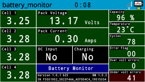

As a comparison, here’s one of my (somewhat abused) test batteries, many under volt errors (and not something I pay much attention to as it’s not used for competition). I’ll run this one down and see if I can get an example of low cell voltage.
medic0
Guess I was typing when you posted the second screen shot. yea, cell 4 is low
Give it a full charge and then let it discharge on the brain with medic running, it should last quite a while with that current draw. I think under volt fault threshold is 2.35V, but medic will show red before that at 2.7V IIRC.
so I ran that test battery down. Here is a screen grab just before it shutdown with under volt error.
