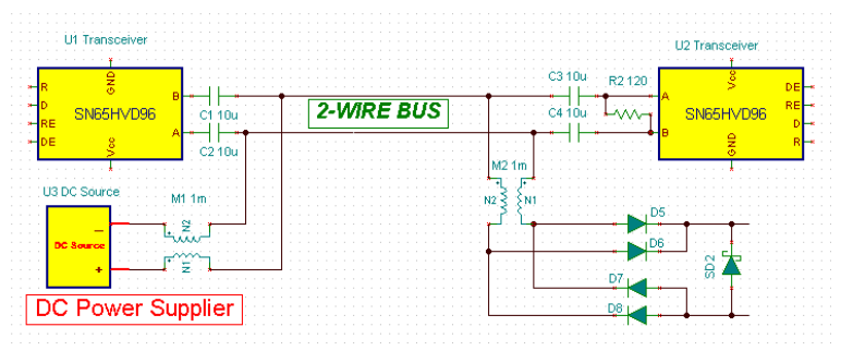

I was wondering if, during the V5 design phase, some sort of wire reduction was considered to communicate between V5 brain and battery over the same 2 wires that deliver the battery power?
There are numerous DC powerline communication solutions developed for automotive industry, smart sensors, home automation, and Power-Over-Data-Lines applications.
You can easily get chips that implement UART to PLC functionality from multiple manufacturers. For example: SIG100 family, MAX20340EWL, or SN65HVD96 that is a relative of SN65HVD1782, which is used inside V5 brain for every port.
(TI Source: Using SN65HVD96 to Create a Power-Over-Data and Polarity Immunity Solution)
I understand that at a time the cost of extra copper in the cable and the custom cable connectors might have been slightly cheaper than the cost of extra electronic components and extra inductors for filtering… But what was the reasoning anyway?
My guess is the reasoning is exactly that. It’s cheaper and less complex than a DC power/data bus system.
