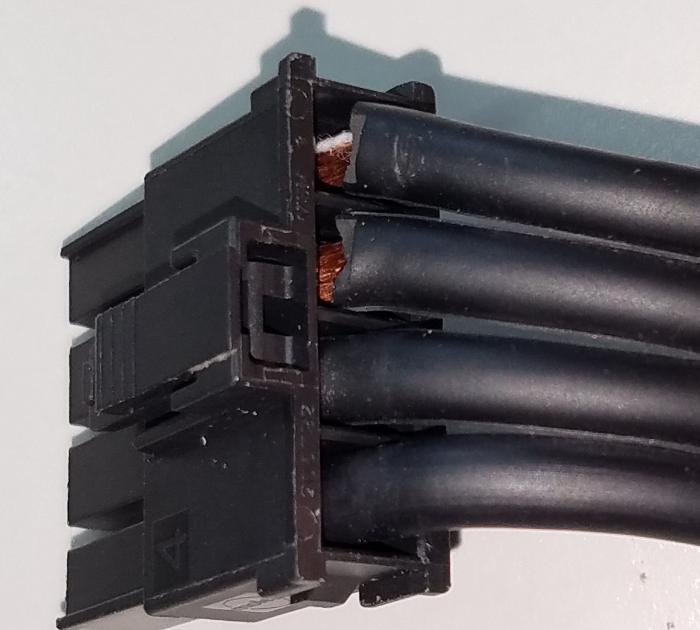

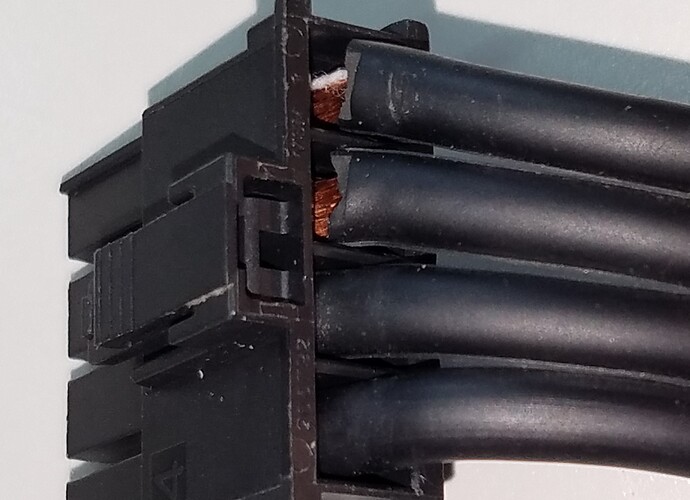

FYI, the bat cable is another weak point for V5. This was the end attached to the Brain. It was probably caused b/c the Brain and battery are orthogonal to each other.BatCable.jpg
Oh thank you, I’ll keep this in mind. My teammate wanted to have the cable like this for space reasons, but I said no
