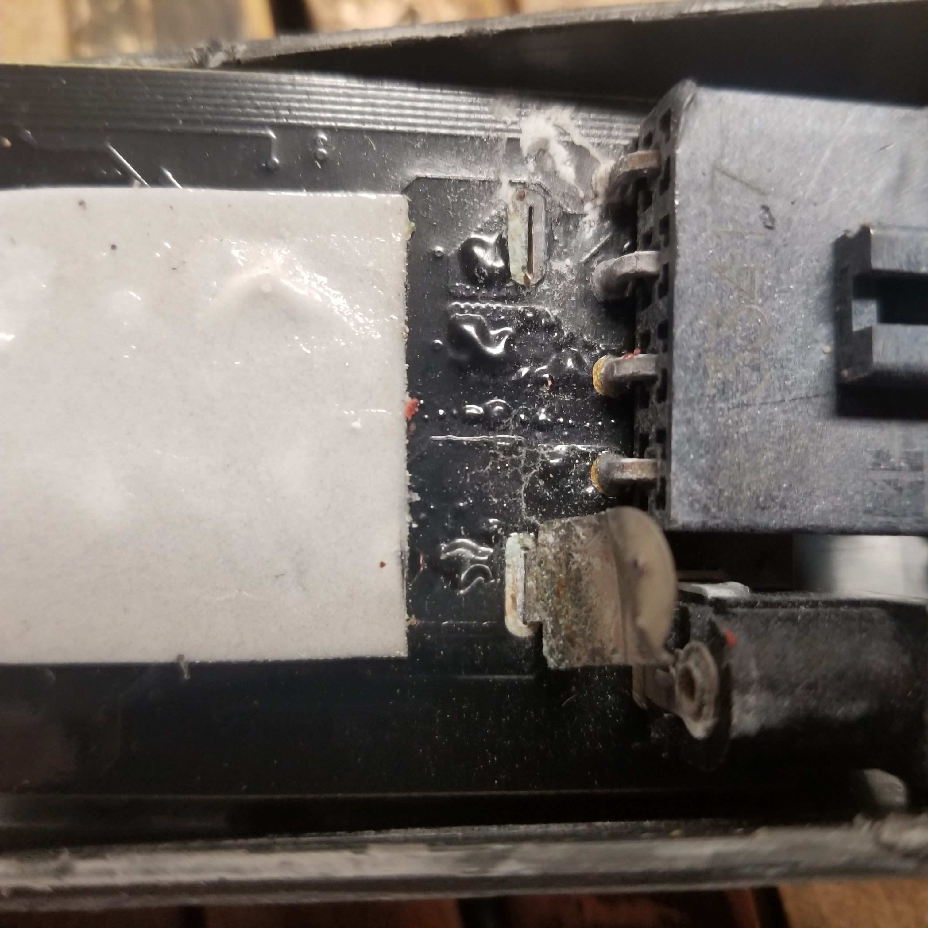

I had a V5 battery die on us a couple days back. The battery would not charge and the red led was flashing when it was plugged in. A couple of days passed when my mentor noticed some dried up liquid around the 4 wire V5 battery port. He had us smell it and the port smelled sour like acid. We took it apart and I took the following images.
square%20corrosion%20back
Here’s a view of the inside top connections for the 4 wire V5 battery port.
corrosion%20w%20cells%20
Here’s a picture of the contacts with the corrosion on the top of the PCB.
back%20of%20PCB
Finally a picture of the back of the PCB. You can see that the pins for the V5 battery port are corroded heavily on the back, as well as a number of other components.
My mentor thinks that one of the cells was defective and leaked acid, which resulted in the corrosion of the v5 battery port connection and the liquid around the port, as well as the sour smell.

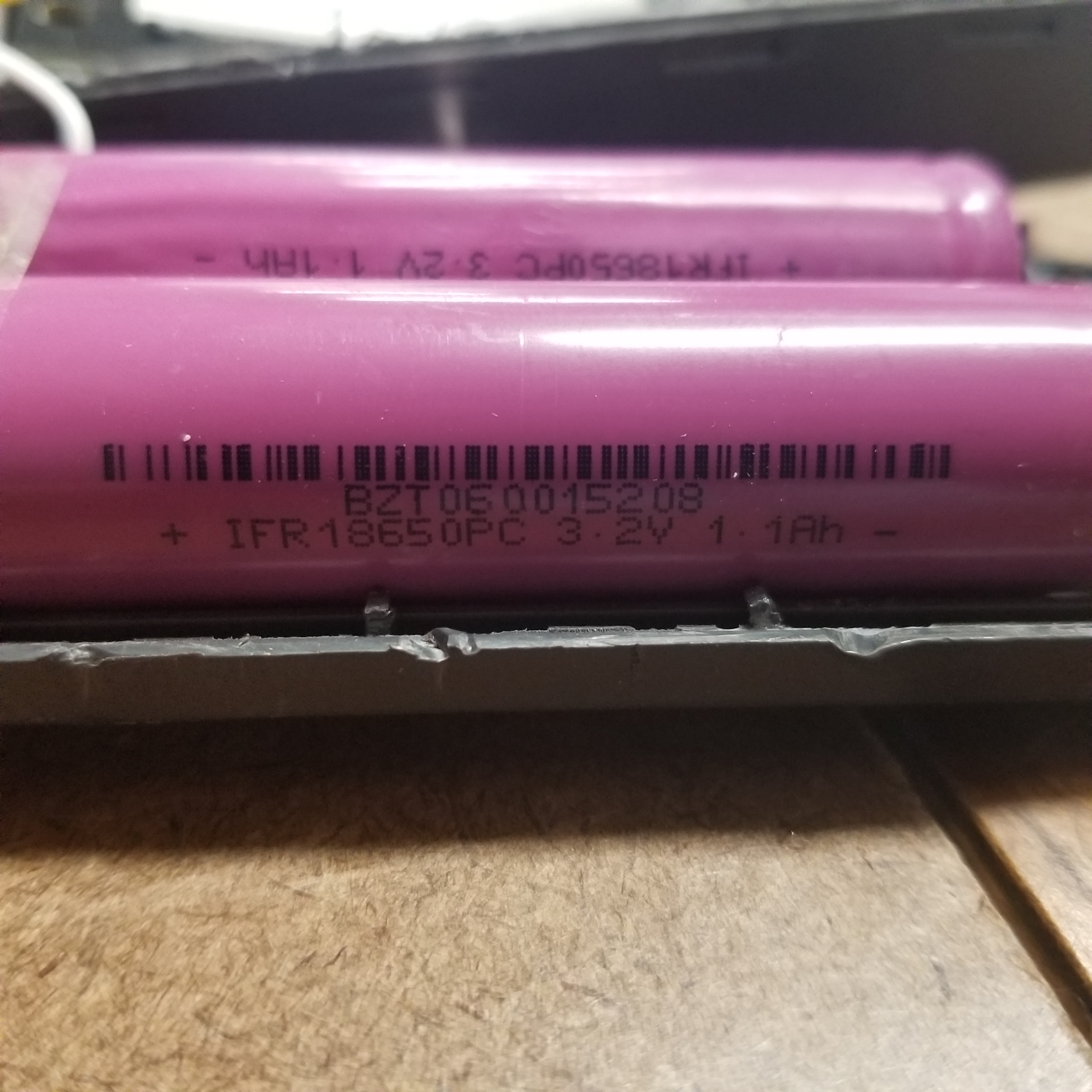

Thanks for providing tons of pictures, would you by chance be able to provide one more of the side of the cells? or is the black information on the side not 100% useful? I am curious to see who makes these cells and exact specs.
I’ll grab a picture tommorow. If I cut into the pink casing will I be hurt?
Probably these or very similar:
http://www.drypower.com.au/shop/product/12877/IFR18650PC.html
I think @vexvoltage wants to see the text that is printed on the pink casing. Usually nothing is printed directly on the metal that is behind the pink (in this case) casing.
Yes this is correct. @meepmeepme Please do not open the cells up. LiFePO4 can get unstable very fast and cause harm or damage.

20190912_122643
Here’s the casing. Don’t worry, I learned my lesson about dangers of batteries when my mentor shorted the contacts on accident.
20190912_122638
Here’s an image showing the surface of the PCB with bubbles. I didn’t notice this the first time around.
