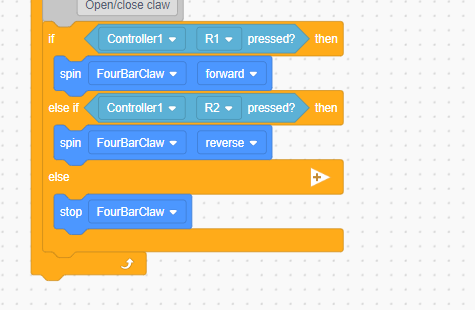

  4. a. Moving the claw motor (1 red motor, with 100rpm) using the right D-pad does not work fine. When we tried the code: “spin (claw motor) forward/reverse,” it acted like a toggle and didn’t shut off after we stopped pressing the button until after we disconnected driver control.
    b. We then changed the claw motor code to: “spin (claw motor) forward/reverse for 90 degrees.” This code spun the motor 90 degrees every time you pressed a button, and shut off immediately afterwards. Unfortunately, it has been acting up recently, and does not spin the motor occasionally after the button is pressed. We aren’t sure whether the problem in this is in the motor, the robot gearing, or in the code. (not using this code at the moment).
tl;dr: My main question (in problems 2 and 4a) on this topic is how to disable a toggle in the V5 Blocks code? As the drive velocity is preset to 50% and certain other settings are also preset, so I assume that there is a toggle preset on the D-pads. Is there a way to disable the toggle present for when you use the spin (motor) forward code in Blocks, or do I have to work around this by making the motor spin a certain amount of degrees each button press?

Motors remember the last state. So if you tell them to drive forward they will continue to drive forward until you give them another command.
If you add conditions to the buttons (if pressed and when not pressed) you will get a better experience.

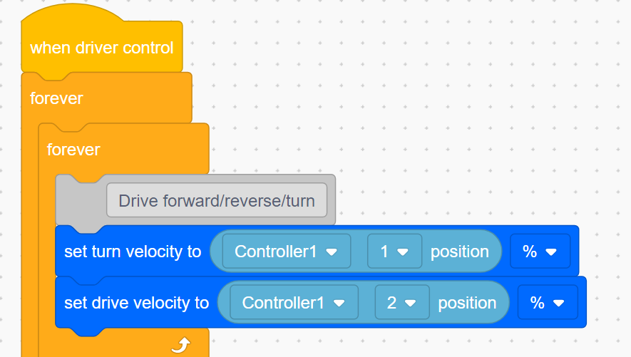

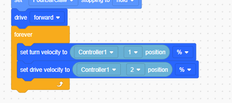

Looking further at your code you are also mixing two sets of programming. You have the drive and turn already established in your Devices list and then you also have code (Button Up / Button Down) to tell the chassis to move forward. It moves slower with the buttons because the default velocity is 50% but when you use the sticks it is applying the full (-100 to +100) range.

The joystick gives a -100 to +100 range with the center being zero. You set the velocity (not direction) and the motors change speed based on this value.
Every control element is separate - not like a gaming console. The joysticks return a range for each direction and the buttons return a true (1) or false (0).

When the turn velocity block is above the drive velocity block, only the drive was working. When we switched it around, only the turn was working. Does anyone know why only one was working at a time?
And will a forever loop as shown in the picture solve this?
