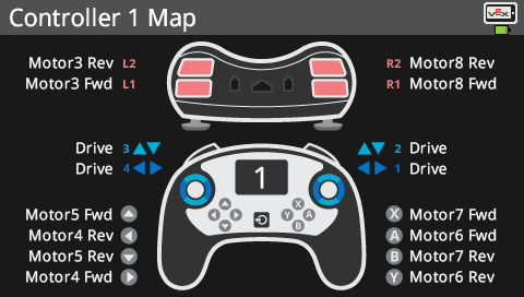

Hard to say if the port is dead or not, check for any damaged pins in the port and perhaps try another cable.
Default drive program has buttons mapped to specific motor ports, here are your choices.
(note, vexos 1.0.12 and earlier will incorrectly show motors 6 and 7 swapped as compared to this screen shot which comes from 1.0.13, below is correct mapping).

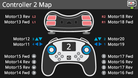

and if you are using a second controller
v5_controller_2
Damaged pins in the port - hadn’t thought of that, I’ll check when I get back on campus next week. We had already tried swapping out the cable, made no difference at all.
I take it then that, with the pre-installed drive program, there is no way to re-assign the controllers and the ports. Is there possibly somewhere a copy of that code (preferably in V5 Blocks - we’re raw beginners in writing code, this is only my second year teaching this stuff, and my PLTW training was in RobotC - which I struggled with horribly) that I could download and tweak for myself? I have seen RobotC clawbot code for the Cortex clawbot posted in several places online, but as of yet cannot find V5 Clawbot code, either in blocks or text. I suppose we COULD write entirely new code if necessary, but as I teach my pre-engineering students - one of the first precepts of engineering is “don’t reinvent the wheel if you don’t have to”.
