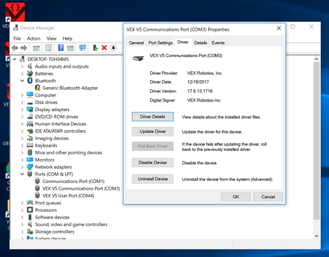

Go to the device manager and, with the V5 brain plugged into the USB port of the computer, check that the ports are showing up. You should see two VEX V5 COM ports as below.
You could also check the correct driver is running if they are.
post back in this topic with any results from this test.
Thank you for the suggestion, I checked and both show up in the ports and both say the same driver version that yours does. However the brain is still not showing up on VEXcode. Also I plugged the controller in and that made the controller icon light up orange.
