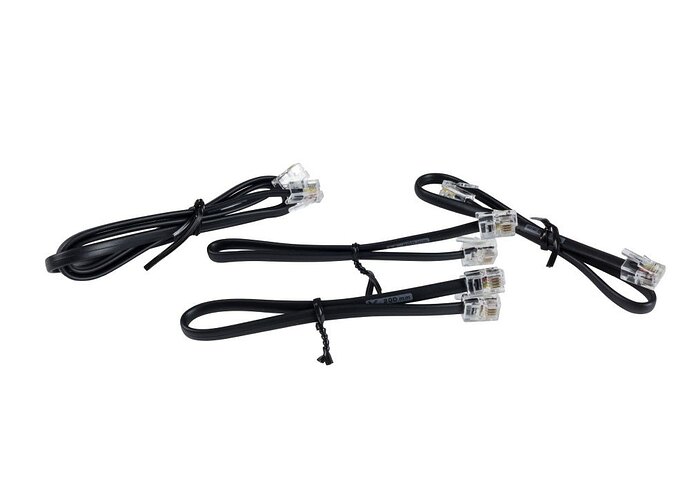

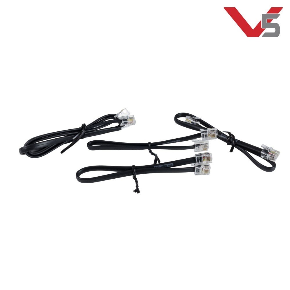

What length of wires are you using? We didn’t have any issues with ports breaking until we had to use longer, manually spliced wires on our robot. I suspect there’s a connection between using long wires and ports breaking, and i suspect it’s an issue on all V5s, and that as more people start attempting lifts with longer wires, the issue is going to start popping up more. I hope I’m wrong and the ports breaking are just a small number of brains that are faulty, but it’s just a hunch that I have. I’m guessing it has something to do with the eFuse implementation…
Our team has a lift and a motor at the end of it but no problems so far. Make sur you made the wires the correct way. Because you have to flip the cable over.Untitled.png but in my unamazing drawing/ the image from vex
you have to make use the wire are lined up so the plastic connecter thing has to be flipped.
I’m pretty sure our wires are made correctly, but I’ll have a look at that tomorrow to make sure the plastic connectors are properly oriented. I’d imagine if you had the wires not properly oriented, the motor wouldn’t run at all, whereas our motor runs for awhile, before eventually killing whichever brain port its connected to. However, I’m wondering if it could be something with custom spliced cables that’s causing the issues; Has anyone had failing ports with factory cables? Could people be poorly making the cables and having metal contacts touching and shorting? I don’t think thats the issue, but its a possibility.
ZoeChow (OP of this thread) said that he/she was using the 1500mm cables made by vex, so the issue seems to not be an error in assembly of custom cables (though of course the factory cable could have been made incorrectly).
