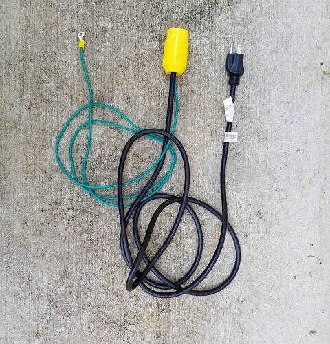

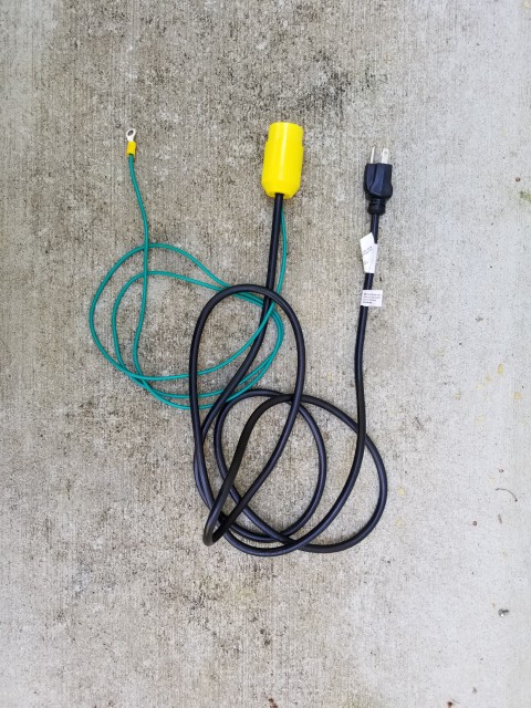

I think with cords like this:
With a cord similar to this one (the green wire is attached to the perimeter via ring terminal where the monitor attaches). This particular cord also serves as a monitor extension cord.
If I have time today I’ll find a photo of the grounding wire they use, which is located on the back of the monitor where the Pis sit.
I’ll find a photo for it.

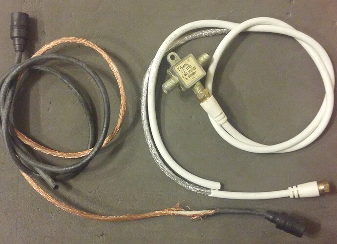

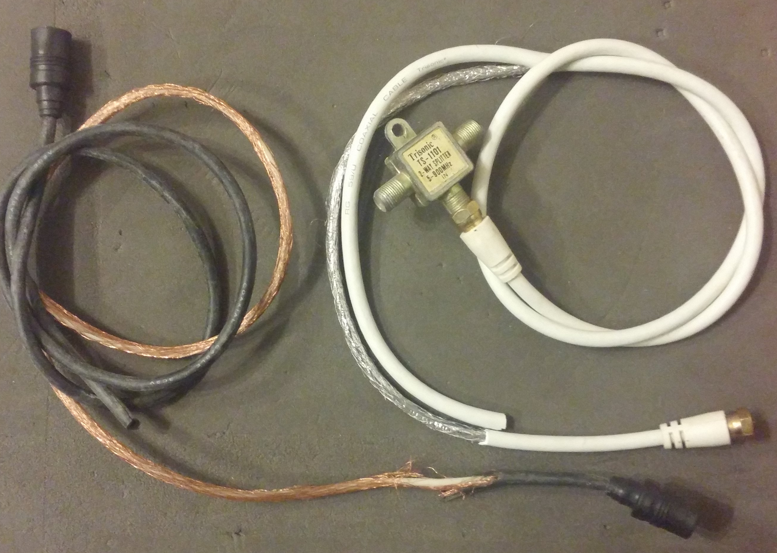

Low- or no-cost alternative for those who cannot share the cost between multiple teams would be to strip some old thick printer or coaxial cables.
However, your luck could vary depending on the size of the bin of the discarded cables that you have access to. I stripped a couple and I didn’t like the braid quality on any of them. Also, newer cables tend to use aluminum foil to substitute for the denser copper braid that you could find on the older cables.
It would be a pain to use any of those two to protect V5 cables, but given enough time and effort it is possible.
Another alternative is just to connect robot’s metal subsystems with any regular electric wire and loosely wrap it around V5 cables, but then you may encounter difficulties explaining to some inspectors how it is legal under <R7j>. I would certainly have no problem letting it pass the inspection, since it is used to protect the cables (and the rest of the robot) from ESD events.
