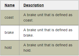

What’s the difference between the brakeType::hold and brakeType::brake?
My assumption is that brake is like the normal thing and hold is where it actively stops the motor from turning. I looked it up, but the VCS command reference only offers this lovely definition:

Still how would you describe the difference between BRAKE and HOLD to a novice?
HOLD I know will return to the position. BRAKE not so sure if you push it from the position it stopped.
So brake is actually a technical term in this case referring to a purely electronic phenomenon. The positive and negative ends are connected and it resists all motion. (assuming I remember correctly) Motors are unable to be spun normally because the generated electricity is “stuck”. Take a 393 motor and short the 2 wires together by touching them against a c channel and you will see it resists motion. You will notice however it doesn’t resist motion infinitely strong, that is due to the efficiency of the motor.
Coast - do nothing like 393s always did
brake - short the wires together but don’t send any additional electricity into the system
hold - actively use PID to maintain the set position
