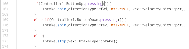

I need to know how to program a button lock in VEX C++. I got an answer before but i do not understand what it means. can someone explain it.
I had asked, “My team was wondering how to program a button lock on VCS. we want to be able to press a button to start the motor and press a button again to turn it off.” We included the image attached below.
This was the responce. “Right now you are using the .pressing() command which returns a Boolean for the button is being held down. If you want an action to perform after a single press of the button, use the .pressed() comment. Have it outside the while loop and have it call a method in which it will maybe change the state of a variable to 0 or 1. Then, if the variable is 0 do one action, but if it is 1, do the other.”
This is the current program.

while (1){

    if(Controller1.ButtonR1.pressing()){
        CatapultLeft.spin(directionType::fwd,CatapultPCT, vex::velocityUnits::pct);
        CatapultRight.spin(directionType::fwd,CatapultPCT, vex::velocityUnits::pct);
    else if(Controller1.ButtonR2.pressing()){
        CatapultLeft.spin(directionType::rev,CatapultPCT, vex::velocityUnits::pct);
        CatapultRight.spin(directionType::rev,CatapultPCT, vex::velocityUnits::pct);
    else{
        CatapultLeft.stop(vex::brakeType::hold);
        CatapultRight.stop(vex::brakeType::hold);
    if(Controller1.ButtonL1.pressing()){
        CapFlip.spin(directionType::fwd,CapFlipPCT, vex::velocityUnits::pct);
    else if(Controller1.ButtonL2.pressing()){
        CapFlip.spin(directionType::rev,CapFlipPCT, vex::velocityUnits::pct);
    else{
        CapFlip.stop(vex::brakeType::brake);
    if(Controller1.ButtonUp.pressing()){
        Intake.spin(directionType::fwd,IntakePCT, vex::velocityUnits::pct);
    else if(Controller1.ButtonDown.pressing()){
        Intake.spin(directionType::rev,IntakePCT, vex::velocityUnits::pct);
    else{
        Intake.stop(vex::brakeType::brake);
Ok, what you can do if you team wants motor to stay spinning without pressing is to define three buttons:
  • spin forward
  • spin reverse
  • stop
else if(Controller1.ButtonRight.pressing(){
this would give three control buttons that will keep the motor doing what you tell them until told otherwise.
