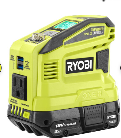

V5 charger compatible w/ ryobi inverter?
Anyone use a v5 charger w/ portable ryobi/milwaukee/etc inverter… the NON sine wave type specifically???
Yeah, my team sometimes uses a DeWalt Power Inverter. 1000 watts, at “Home Depot” it’s around 130 dollars USD.
Just ran a test with this model with a 6Ah battery.
It charged (3) v5 batteries at once (plug splitter with 3 vex chargers) and went from full battery (4 bars) down to 3 bars. Batteries were 25%, 50%, and 75% initially.
No weird sounds/smells/heat were noticed. The vex charger read exactly the same voltage output on regular ac power as the inverter (to 2 decimal places on my meter)
